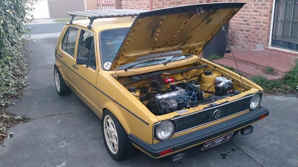

the webber i had i have pulled apart and cleaned and put on the car and seems to be running well is a little hard to tell as the car is a 78 there is a exhaust recirculation emissions thing that wont fit with this carbi so i bought a new head and manifold to port and polish and get the head decked. so far i have port and polished most of the intake manifold. and will be doing the head later on.
i got some saas bucket seats that used to be in a kingswood i have fit the drivers side but the stock passenger seat is proving to be hard to get out as the screw at the front will not come undone so is soaking in zep7 so we will see how that goes
also i got a new nardi for my mx5 for my birthday so the golf got the hand me down. i also drilled out a nardi hand brake handle to fit the golf, so the interior is really coming together.
I have cleaned it a fair bit since this picture

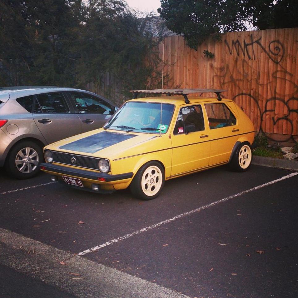

I originally made the roof rack for my volvo 360 glt (miss that car so bad)
It's just standard square tube gutter mount roof rack with slats from a futon bed drilled and counter sunk on a drill press to make it faster. If you do it as well differently treat the timber first with something design for out door use like decking. As I need to do that and pulling it apart to do so takes a bit. Also the way the brackets adjust for different roof widths can get in the way jus make sure you adjust them first then measure and drill a very cheap and super handy thing to have.
