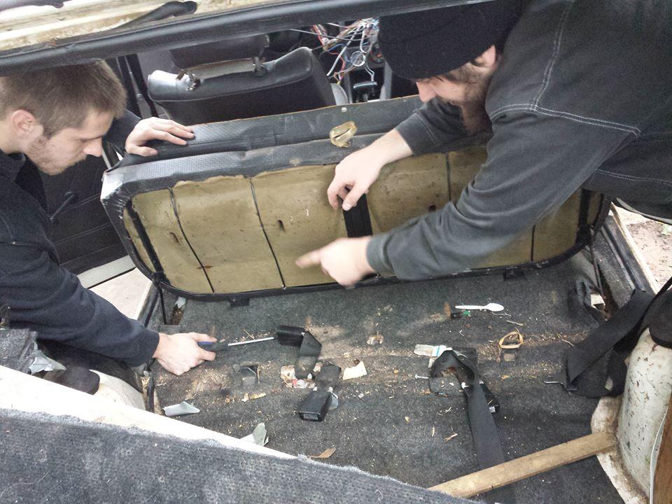

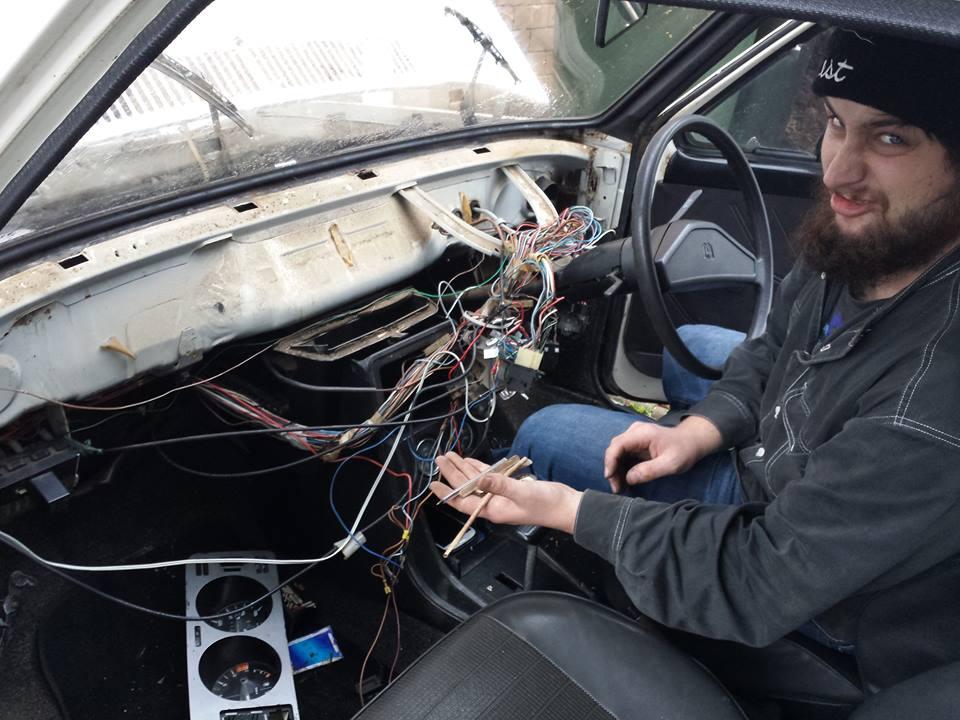

                  So, there was an auto swallowtail for sale for a while on Gumtree. Someone bought it, we ended up finding the new owner on Facebook through a Euro group, and surprisingly he lived around the corner from where my missus lives. Car itself is a 2/76, and is the earliest one I've seen in the flesh I'm pretty sure.
                  We met up with him and got some problems sorted on his Golf, including:
                  - replaced bulb in left hand head light
                  - replaced parking lights
                  - replaced left hand front indicator
                  - swapped out the air intake and filter box for some good ones
                  - got the high beams working
                  - got all the instrument panel lights working
                  - swapped the really crap dash with a not as crap dash
                  - replaced the bolts on the cam cover
                  - re-secured the battery mount
                  - replaced the middle water pump hose
                  - replaced both windscreen wiper arms
                  - swapped out the sun visors for some factory ones
                  - replaced the indicator stalk as the old one was busted
                  - installed a dash mat!
                  - installed a new fuse box cover
                  - cleaned out a fair amount of crap out of the back

                  • So other than an old straw and a few pens did you find any coins
                    I hope you paid a fair price for her given how much work you had already put in.
                    2.0 TFSI Stage 2 Tune by DriverMotorsport
                    • Originally posted by gazzmo View Post
                      Found a 5c coin haha that's about it. Yeah I'll be paying a very fair price for it

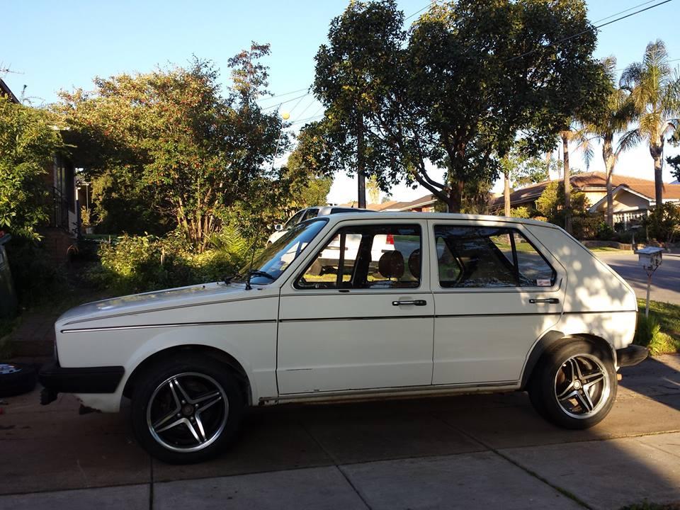

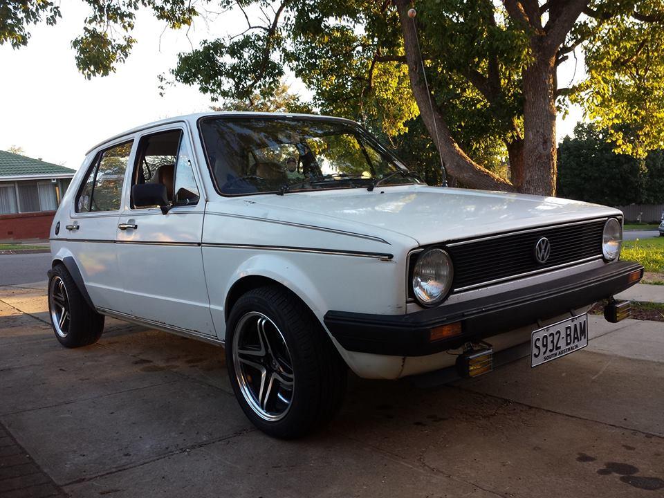

                            Enkei Big End Rodders, 15x7 +35 with 5mm and 20mm spacers in the front and rear respectively. The fronts poke about 5mm and the rear almost pokes so I really only want 15mm in the rear and none in the front (unless a fender roll and some camber up front bring them in) but the wheels don't clear the calipers the rear has settled since putting them on but the front needs to be brought down, happening next weekend.
                            The fenders need to be rolled, I have access to a fender roller but not until next Saturday so I may just do the ol' cricket bat handle trick to get me out of trouble.....maybe.

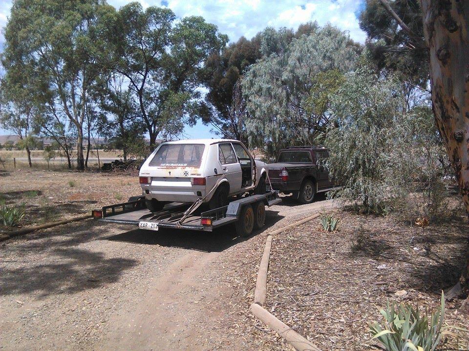

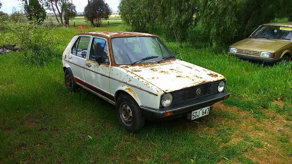

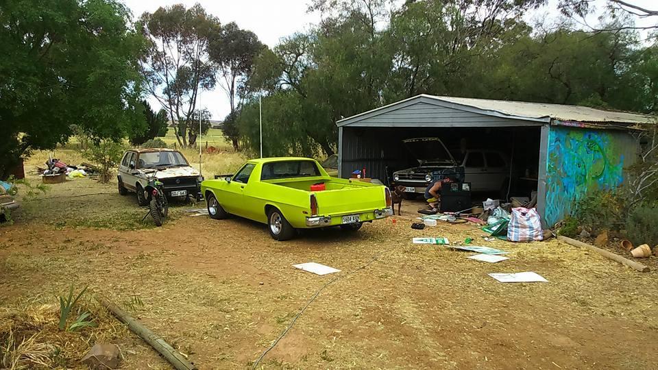

                              Things died down for a bit but then one morning I woke up to find there was a couple of Mk1s up for auction in a large deceased estate auction comprising of mainly aircooled VWs. A $20 joke bid was made and a few hours later I was surprised by a phonecall saying I'd won one! Excellent. Another white 4 door diesel, can you believe. I can't escape them!
                              The thing had been unregistered since 1996 and showed it haha. With a LOT of encouragement (and Start Ya Bastard) I got it fired up. It was soon apparent why it'd been retired, it had nearly 400,000km on it and a cylinders worth of exhaust was pumping out of the valve cover. Ahwell. This car had many plans made and changed and has eventually found a home. The floors and sills are rotted to hell but the rest is surprisingly solid.
                              The car itself is a tad strange though. It has a button on the dash for the glow plugs (I assume this was fitted by a previous owner), it has a strange Japanese sticker on the timing cover, original starting instructions printed onto the windscreen, and no month/year of manufacture stamped into the ID plate. It also has the early style earth points above the glovebox.

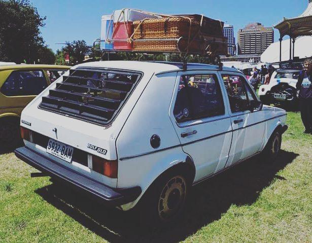

                              Volksfest was that weekend, so once it was safe to go home I got my butt into gear and got it ready to show off publicly for the first time in more than a year. The engine I put in isn't fantastic but it's also been rebuilt at some point. It has a non genuine head, oil baffle in the valve cover, a weird temp sensor (which doesn't work with my plug), a strange oil pressure switch (which I swapped out), an extra threaded hole in where to coolant goes into the front of the head, and an extended dipstick tube. Plus the block and valve cover have been painted red. It's not fantastic in the way when its cold it struggles to start it runs on 3 cylinders and smokes hardcore, with some compression blowing out of the intake. When it's warm though it's fine and runs fantastic, although still has air coming out of the intake. A mate has suggested rings, which I thought first, but the smoke it blows when cold is black. I think its something to do with the valves, or even a crack between valves, which closes when it gets to op temp. I dunno. Its getting worse though, some days its almost as if the timing changes as it will go very tinny and clacky and be slow and then later it'll be fine. I dunno. I'm driving it daily atm until I get the Disco registered.
                              Anyway, after that novel, have some pics lol

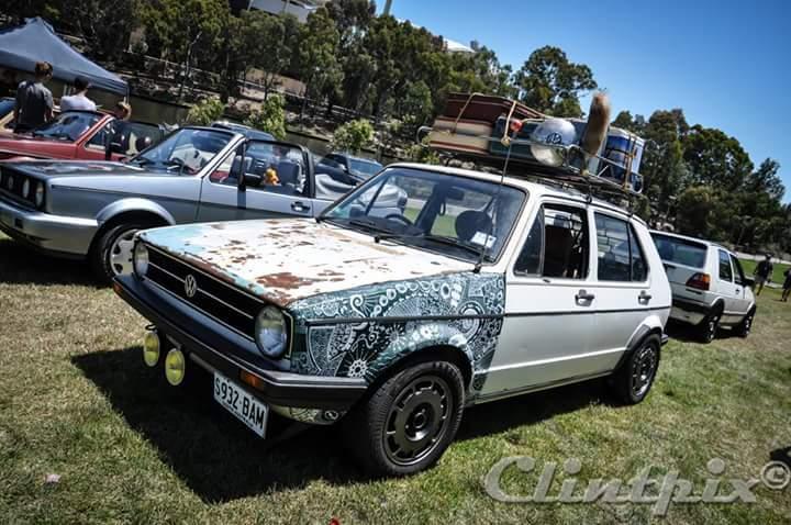

                              We got a few Mk1s (and a couple of Mk2s) to Volksfest, so many in fact they let us have our own area

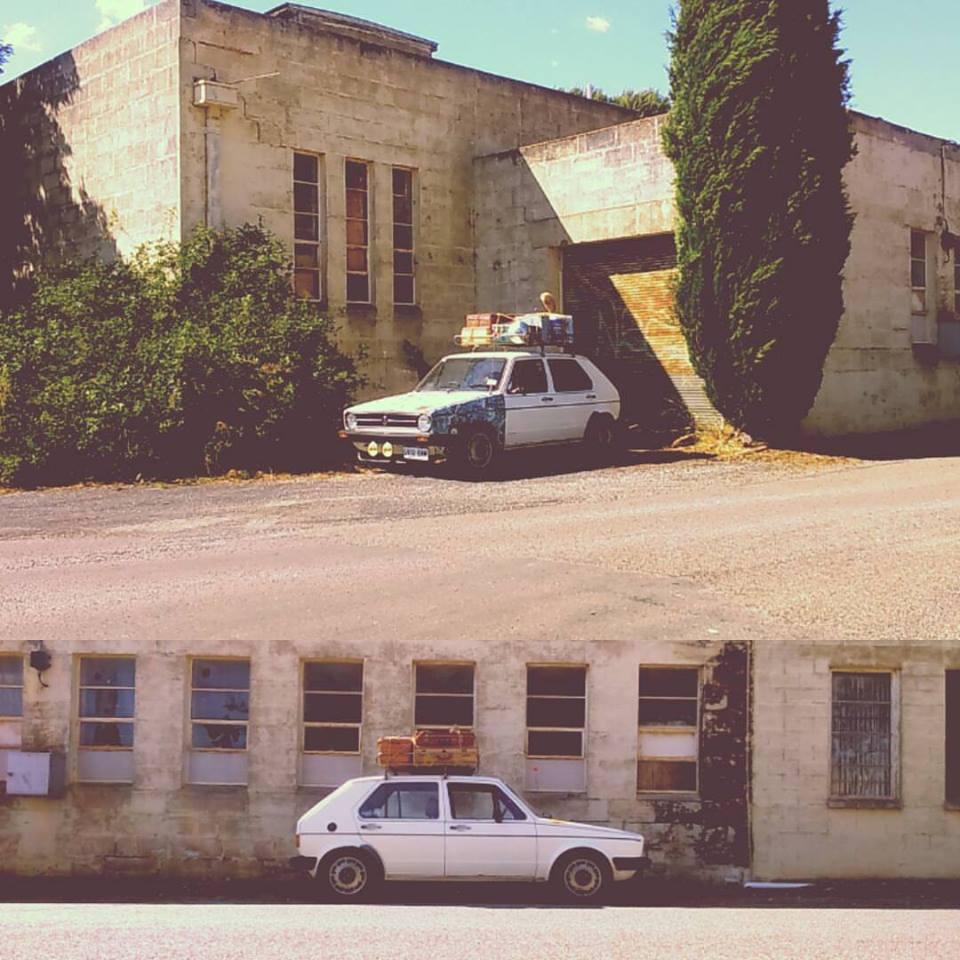

                              And my fave pic of it so far. I always pass this abandoned building and finally bothered to stop
                              I have put the original bonnet back on as well since those pics.
