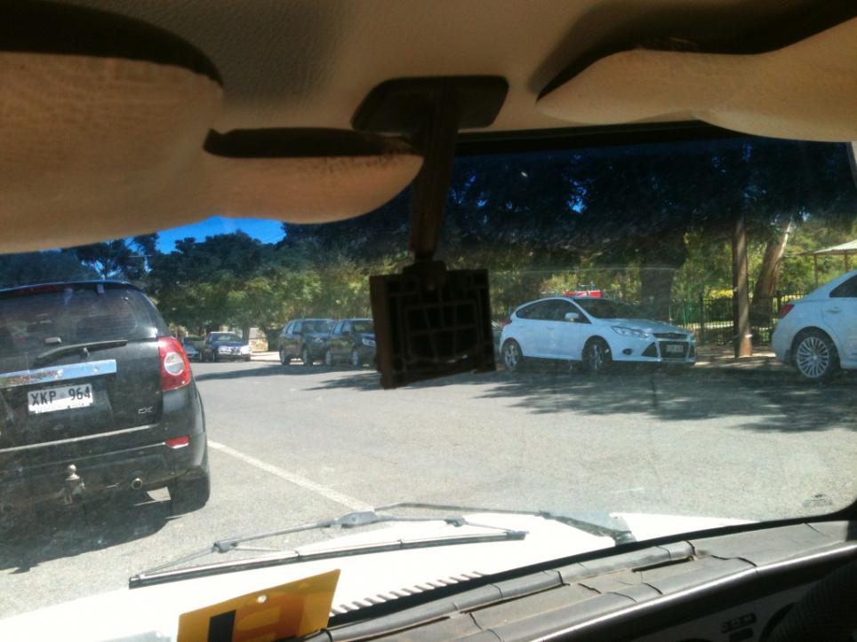

              No rear vision mirror :/

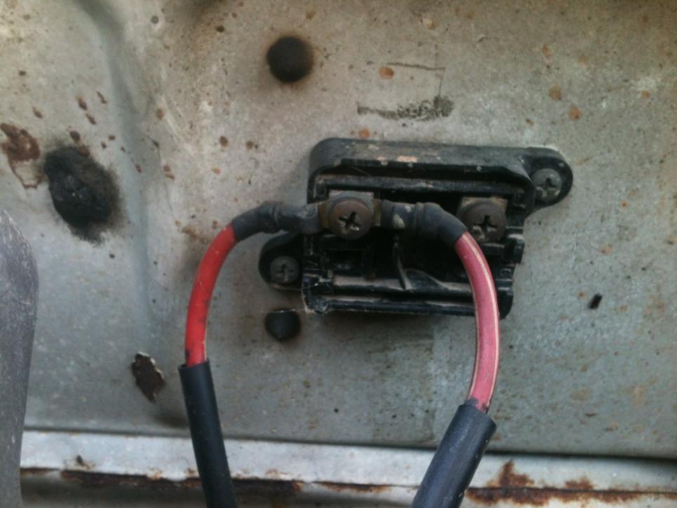

                        So I put my battery in, pulled out the cold start handle, let the glow plug light go out, and turned it over. Repeat a few times and I knew something was up. Checked the under dash fuses, everything is good. Followed the glow plug wires to the fuse on the firewall, and found it was blown. Nek minnit:
                        I'll be replacing it with a 50A blade fuse tomorrow.

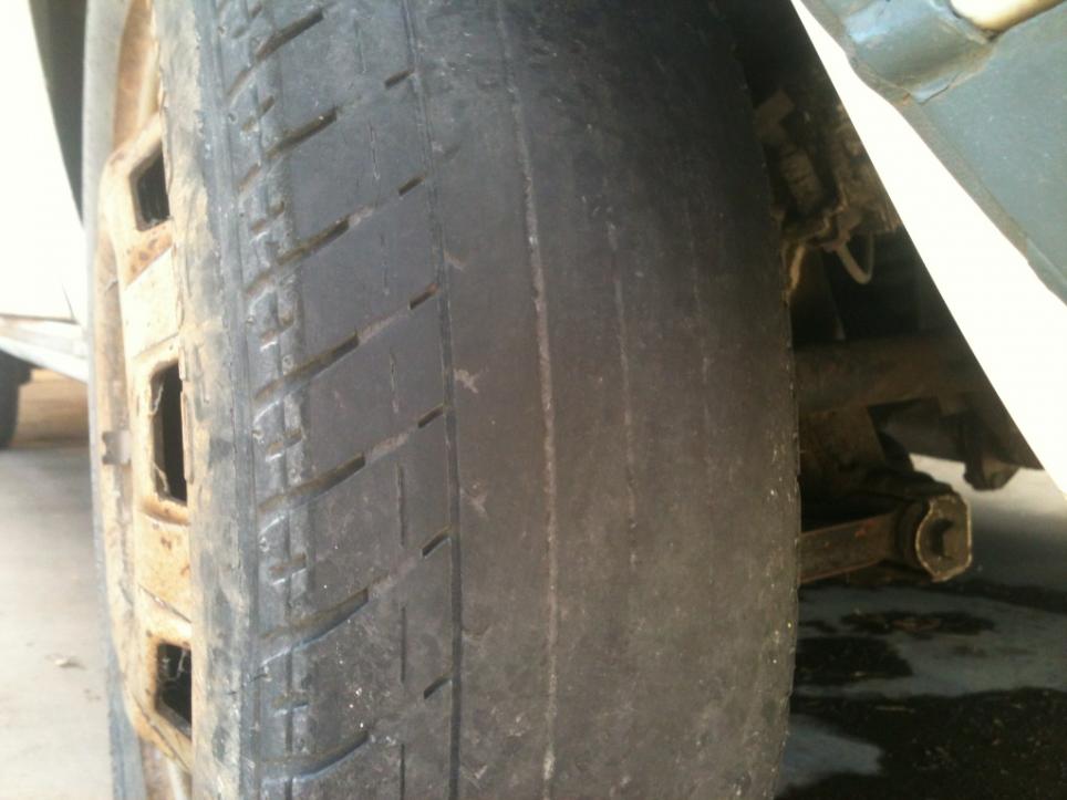

                        Also getting replaced tomorrow:
                        Local tyre place has a pair of second hand tyres for $35 fitted each

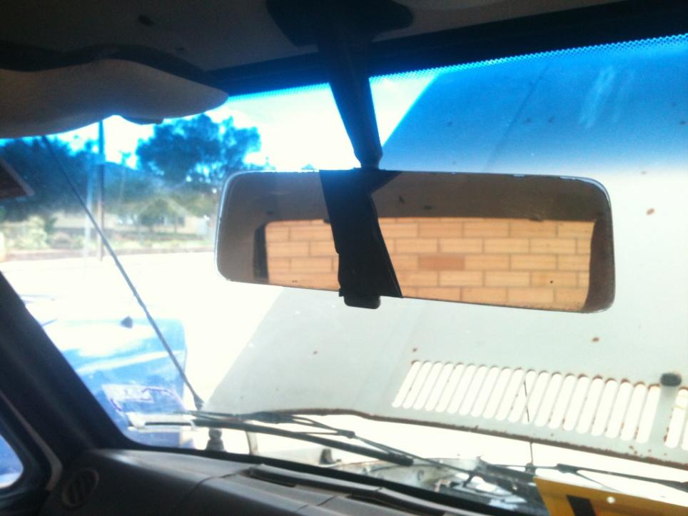

                        I also fixed my mirror
