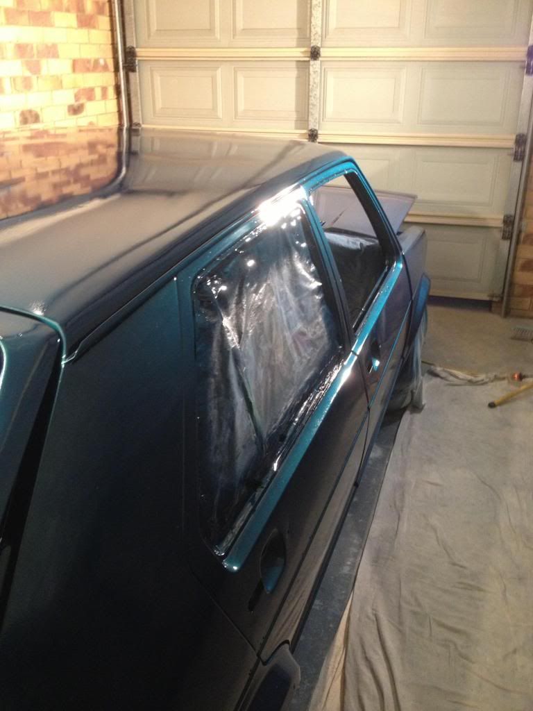

Damn that's a great colour!
Keen to see more

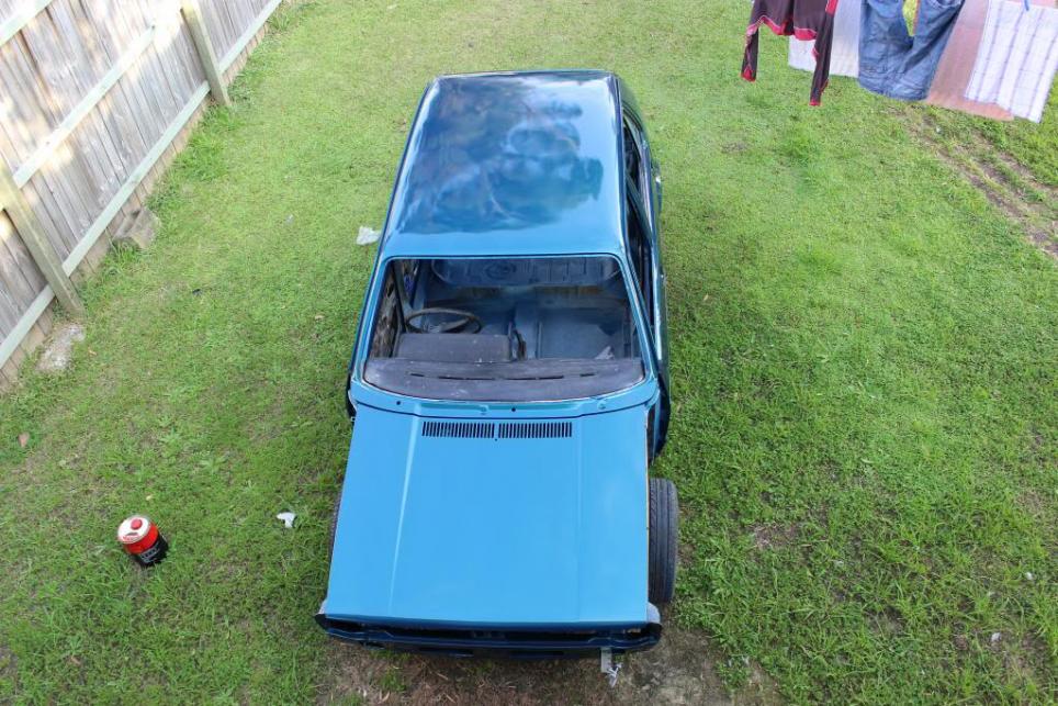

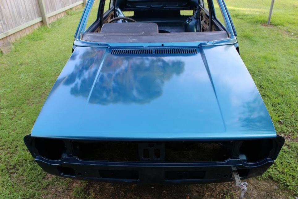

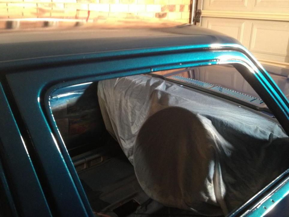

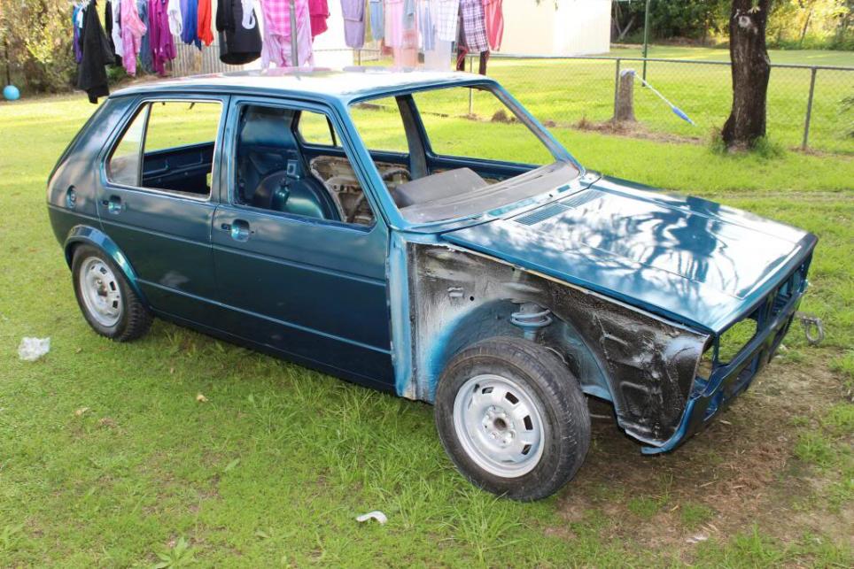

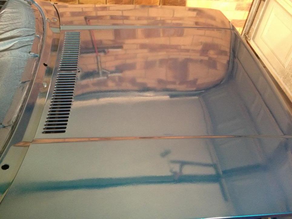

Well, after those pics were taken, I did indeed have a crack at the clear coat. 1st spray seemed to go on quite well, however with a compressor failure on the next spray I ended up with a huge mess of runs and thick, splodgy crap all over my lovely new paint.
So, fast forward about 7 weeks or so, and I have just had the car dropped back off at my place! Had to basically sand the whole car back, and spray it all again, start to finish, inside and out. So now with 2 full spray jobs under my belt and a car I'm actually happy with, I can tell you I will never ever be doing that again lol. Will post up some pics later, but with a public holiday Wednesday I'm pretty sure I'm going to gut it completely and get cracking on the rebuild, again more pics to follow. Wish me luck!'77 Golf mk1 GLS - ground up resto - Sold

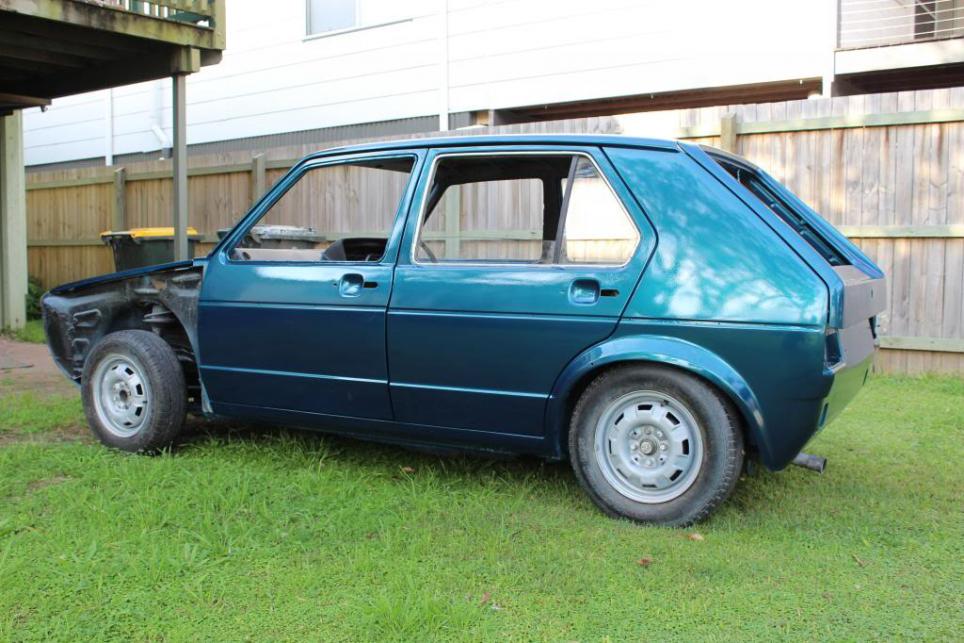

Wow, I think it's actually been 9 months since I was in here last, holy crap time flies.
The car has been completely gutted, the entire steering/suspension/brakes have been completely rebuilt, not a single nut or bolt hasn't been touched. It's a happy roller now, and with the 020 5 speed just being finished with its rebuild this week I'm looking to finally have a full drivetrain back in the car. Also found more rust in it after paint but nothing exterior so you can't tell we had to repair it after all the paint kafuffel.
