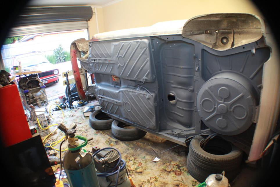

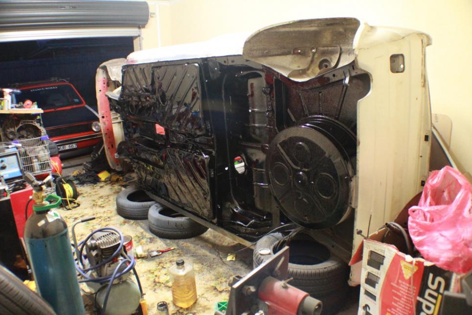

Also managed to paint the underside of the car with etch primer. First time ive used compressor and gun, and actually think i did pretty well. Might consider spraying the actual colour in the interior to save some money and spend to spend on something else. Will be getting a tub of bitumen and painting the entire chassis/underside with a few thick coates.

First coat done, tried to get into every crevice etc. Really wrapped bout the way it turned out !! Bitumen ftw

Haha only because i couldnt get to the bottom ones as the car is flipped and no space.. ill do all 4 when the cars is on its feet again heheOriginally posted by gecko2k View PostMay I ask why you didn't spray the inner arches with the bitumen? Sorry I'm a noob...- Orange Golf mk1 LS, 1.8 5speed, 32/36 - sold

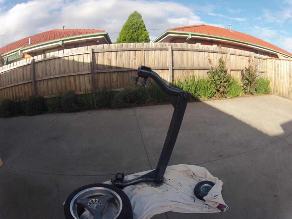

Also cleaned and sprayed the beam. Looks much better

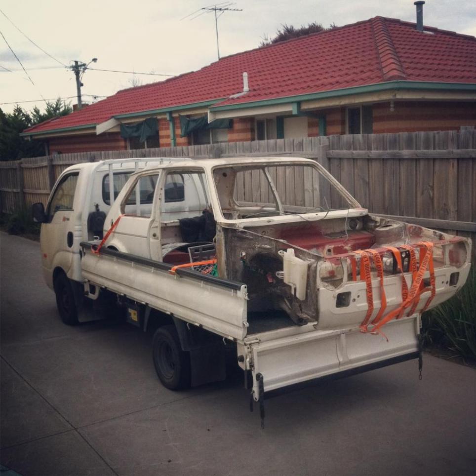

Took 5 mates to lift it, and put in on the tiny truck hahaha. Good times!

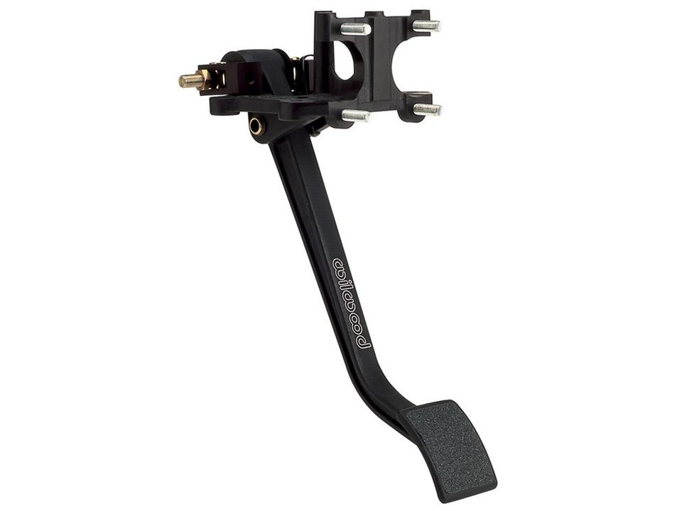

Anyway I am planning on doing a complete engine bay shave, including brakes. I am looking at this Wilwood single pedal with dual small M/Cs. I think this will work perfectly, as i just have to weld on mounting tabs/brackets to sit it in. I know a few of the guys have done this before me, any insight?
Wilwood Swing Mount Brake Pedal Assy 6 25 1 Ratio Dual Master CYL WB 340 5181 | eBay
Also what kind of M/C sizes am i looking at getting. Will be running GTI carriers and brakes at front, with mk3/cordoba drums at rear so do i need a 60/40 distribution or?- Orange Golf mk1 LS, 1.8 5speed, 32/36 - sold

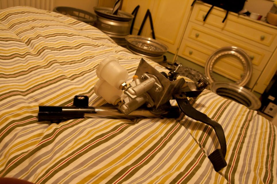

I have been doing tons of research and found a few pics of which way i would prefer to go. Out of all the solutions, i think the best/safest/easiest would be for me to buy the Wilwood pedal and then make a small cage/brackets to sit it in the cabin. Ideas?
I really like what's been done here, but his Tig skills surpass me by miles, so im quite scared to do this.
So im thinking of adding this, its reasonably cheap. Just scared that the pedal is longer than the mk1 pedals which will look odd and create issues with the reservoirs. Any one used the wilwood pedal box's?
