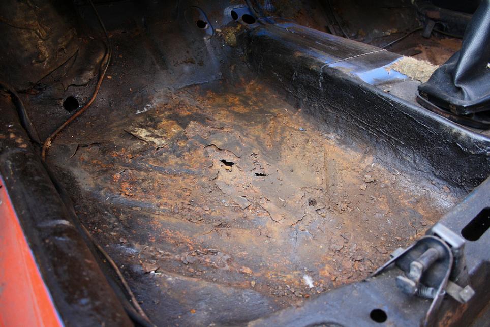

            • #21
              Dang thats a lot of rust. I hoep the car didnt cost ya too much... Id be a little concerned if the previous owner said it was rust free.
              • #22
                Nah, the PO didn't say it would be rust free. I'm obviously not happy about the amount of rust, but you've got to learn this stuff some time.
                I've taken some more pictures of the strip down progress, I'm just having some drama getting the front seats out. They seem like they look different to all the other pictures of the rail fronts I've found. They don't have a bold right at the front of the rail (that I can see).
                Any ideas? Do 76ers have different seats?

                • #23
                  should be the same system, there is a little screw under the front locking part of the seatbase that you unscrew and take out the metal clip that it holds down, then it should slide all the way back
                  • #24
                    Thank you heaps Dan - I tried that yesterday arvo and it worked like a charm, seats are out and rusty floors exposed.

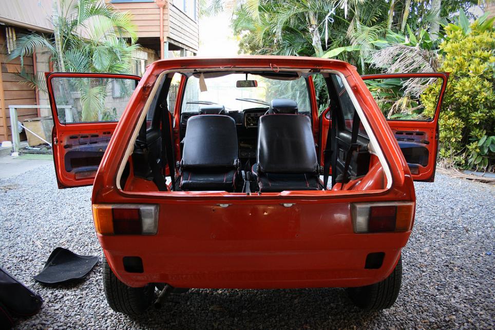

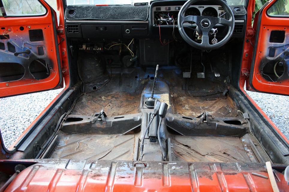

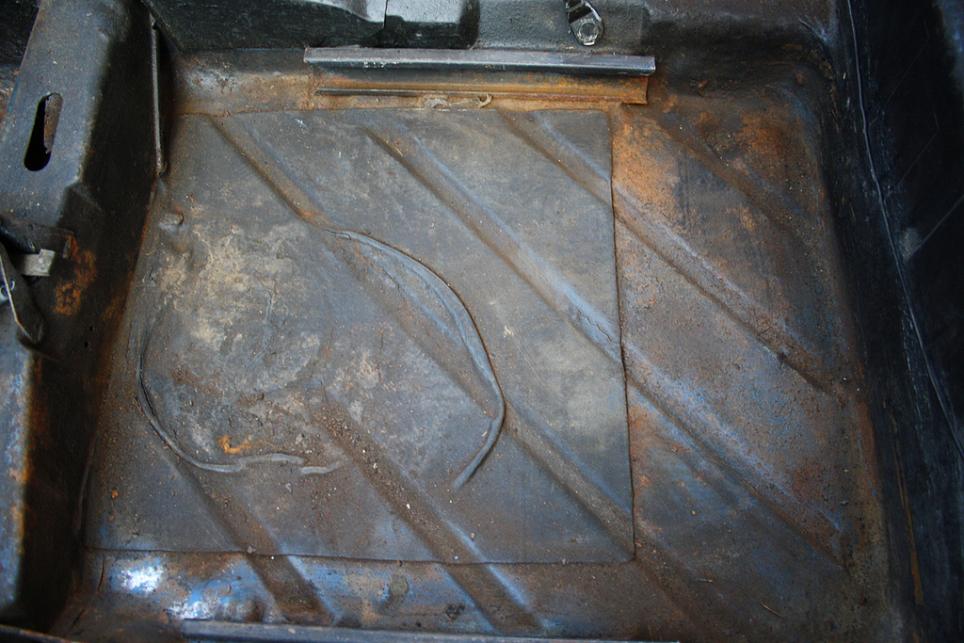

                      So I've pulled the hatch off, removed the seat belts, taken out the front and back seats, and removed all the carpet and foam padding and newspaper from Golf so as to check out the state of the floors.
                      After I took Dan's advice and removed the little screw from the tab the front seats slid right out and I was set.
                      And some good news finally, no rust in the front driver's side quarter (from first looks)
                      And a big thank you goes to my two friends:
                      Noob question:

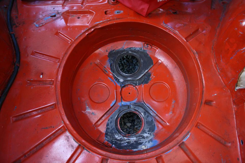

                      Also, I've highlighted some stuff in the photo below - I think it looks like some type of tape or fibreglass from the factory over some random holes. Anyone seen this before and have you removed this stuff and replaced it with something?

                      • #26
                        It's just tape. I'd replace it with race tape or aluminium tape.
                        7? MK1 Caddy
                        79 B1 Passat Dasher Project
                        12 Amarok
                        • #27
                          Or weld the holes shut? Are they only for the small amount of rust proofing/cavity waxing from factory?
                          • #28
                            I was thinking that might be a good move, once I've taken the fuel tank out obviously
