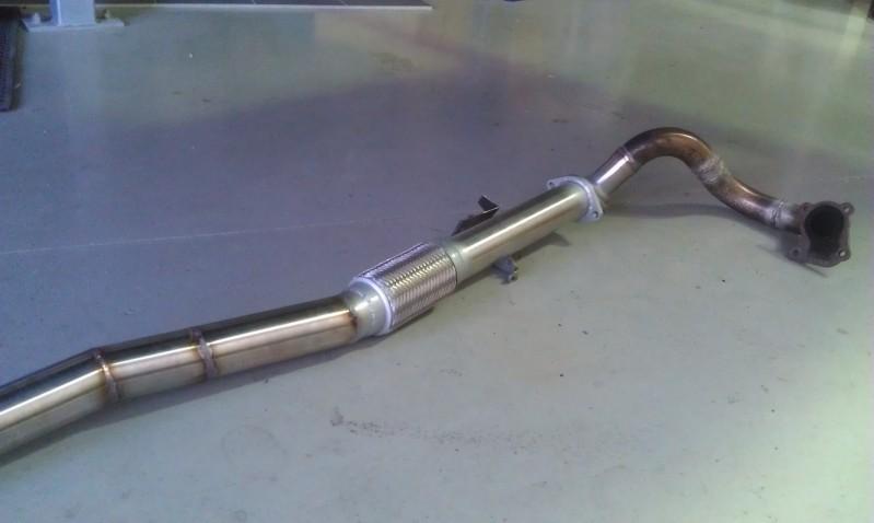

        Set to do the exhaust on saturday.... but I'm chicken-ing out on the straight through no mufflers claim - I have bought a glasspack SS offset (but straight through perforated) muffler. Will take a vid of the noise with no muffler for all the folks but I think the muffler will be going on. I don't need droning on the highway, which is all I'm worried about really.
        If it seems quiet enough without the muffler I may yet leave it off

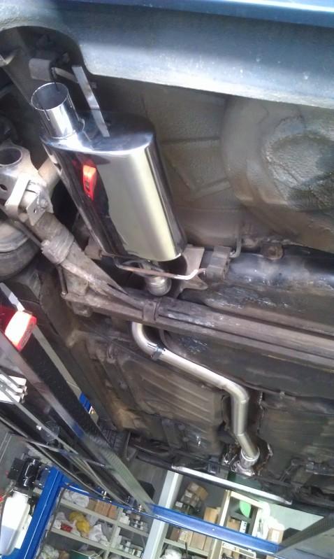

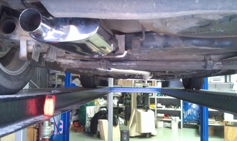

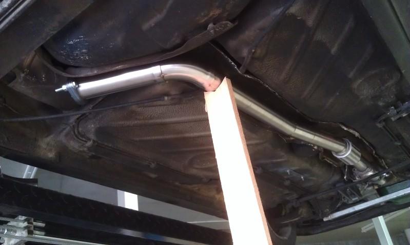

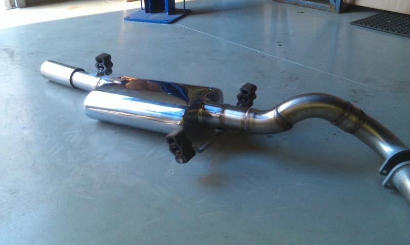

            So I wussed out and used the muffler
            was a long day - started at 7.30am and finished the exhaust at 4pm... stopped for 10 minutes in the middle

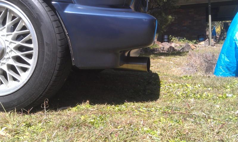

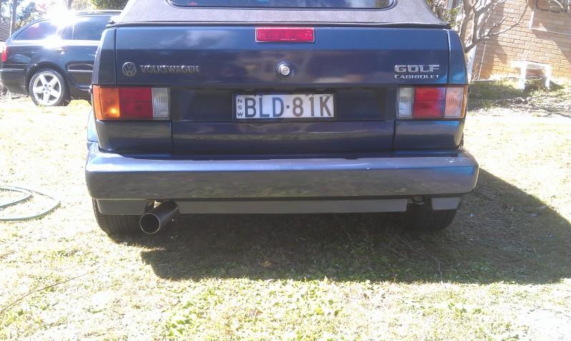

            Made a 3" tip, by flaring the 2.5" pipe out to the ID of a 3" sleeve over the end, and TIG fused the end together... more pics (of the outside) tomorrow

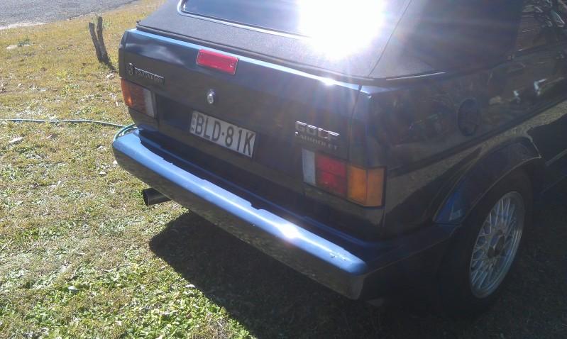

                    more pics
                    '98 Mk3 Cabriolet 2.0 8V
                    '99 A4 Quattro 1.8T
                    • Top stuff, mate.
                      • very tidy job, And sounds mint. Also i like your seats in the they look awesome with i had new upholstery. Looking good anyway nice to see another cabby on here

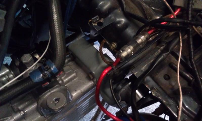

                          Took these pics today when swapping in yet another gearbox.... happy now with the ratio's (this is a '6W' code gearbox, from an Austin Maestro!!!) which appears to be the same ratio's as the 4+E gearbox of mk1 turbodiesel era.
                          I have fitted up one of my new 5 speed conversion mounts -
                          And I might say they fit wonderfully and look the part, I reckon.
