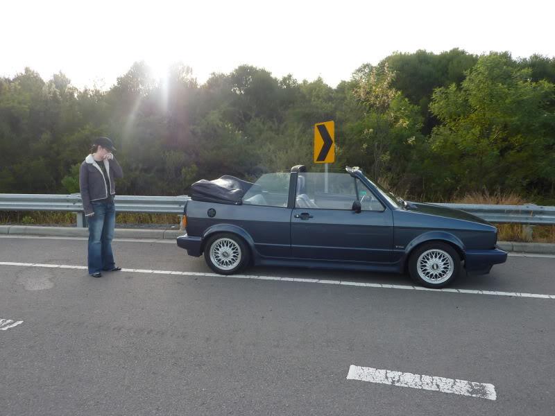

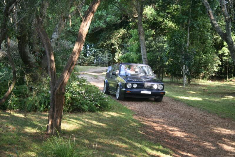

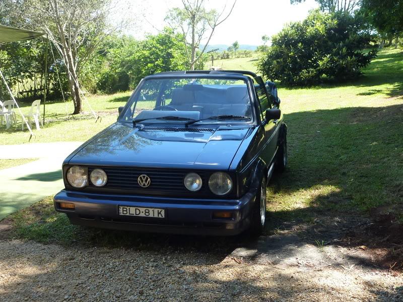

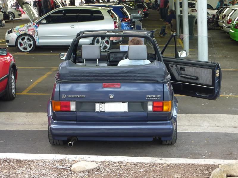

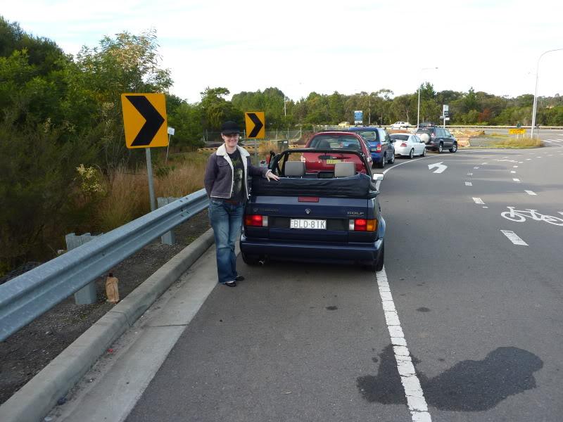

    This is how the car looked recently at our wedding and at the 'nats.:
    Nationals day...
    Wedding day...

    very pretty

      That's a really good looking cab, love the colour and that you're going the diesel route.

            Not a huge fan of the 'Cabrio', but this one I really like - very nice!

              Thanks! I think the Blue really suits the car, especially with the bbs rims. I never wanted a cabby, but we got one (it was diesel and my wife liked it) and since then we've fallen in love with it. The way they feel on the road is so good, driving it always puts grin on your face. Plus, driving a car with no roof is awesome.

                This thread made me look some up on carsales Agree, the wheels suit the car very well, plus the colour and body kit (although I think this is standard?) are just spot on, too. Nice

                  yep, thats all standard 90's cabriolet body kit.
