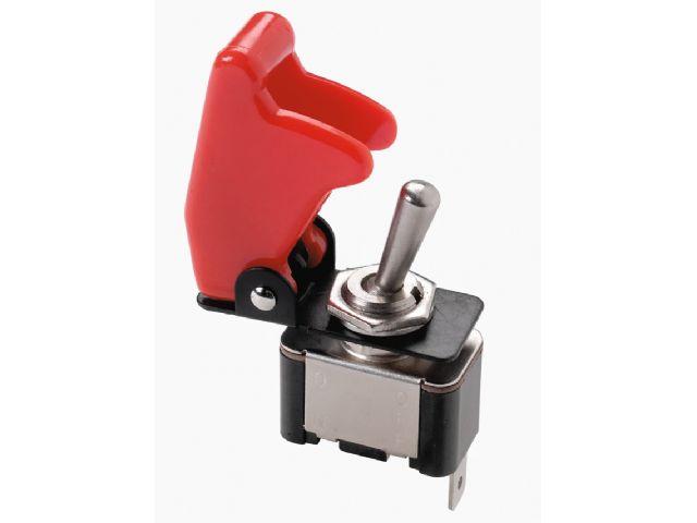

The Boost control is the best mod yet as far as I'm concerned. What I've done is to tee off the brake vacuum for some vaccuum supply, and run it to a solenoid valve (available from Jaycar). This supplies vacuum to the backside of the wastegate actuator when open - BUT - you need to bleed air back in when you want boost again, so a second solenoid valve is teed into the line between the first valve and atmosphere.
Using a good quality 2 way relay (that has a 81a and 81b terminal) its then easy to switch it using a simple toggle switch. So, I have a switch on the dashboard now: When its switched one way, the vent valve is closed and the vacuum one is open (limits WOT boost to about 4psi). When the switch is flicked, the vent valve opens and the vacuum one closes, and you get full boost (17psi!).
