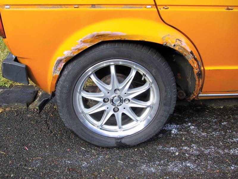

                      Some pics - you will see why we are sad about losing it

                              That looks quite repairable.
                              The door gap is good and the panel damage seems to be confined to the outer lip of the guard.
                              The beam has moved backwards, depending if it has taken the chassis rail with it, it could just be a matter of replacing the beam and repairing the mounting studs.
                              To get it back on the road quick I'd concentrate on the rear beam and rough out the guard covering it with a GTI set of flares.
                              I've got all the bits here to save it.
                              Pete
