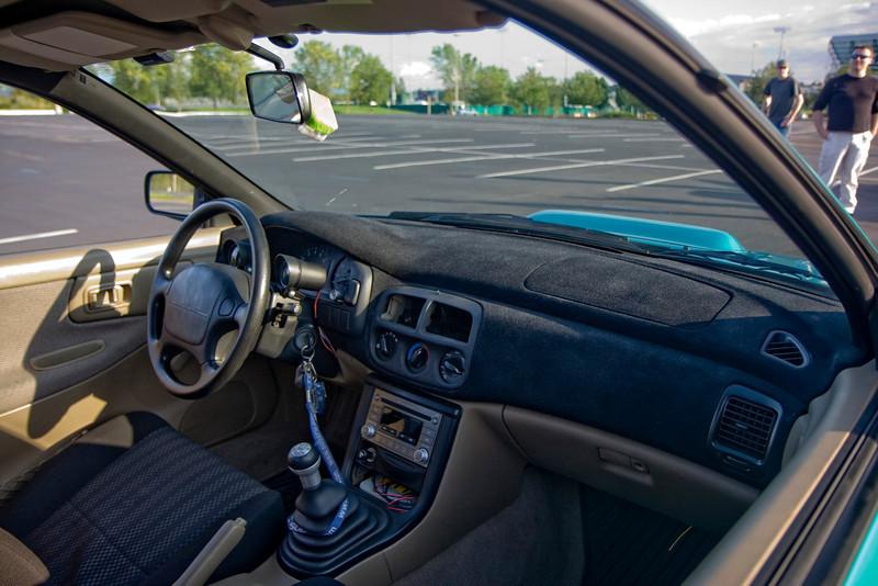

      Is idea of using flocking in the dash for sound deadning purposes?
      I didn't quite expain my flocking question right. There is this type of paint that has fabric fibres, they use it a lot in England mainly on Dashes, Card cards ect, ect. I didn't explain it very well, but maybe this will give you an idea?
