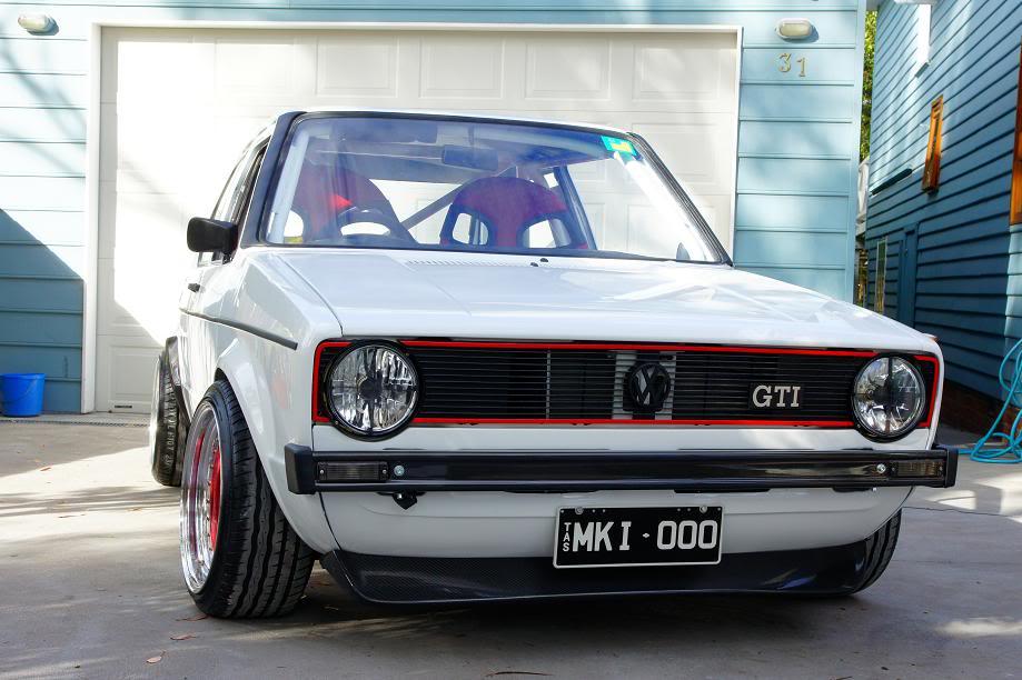

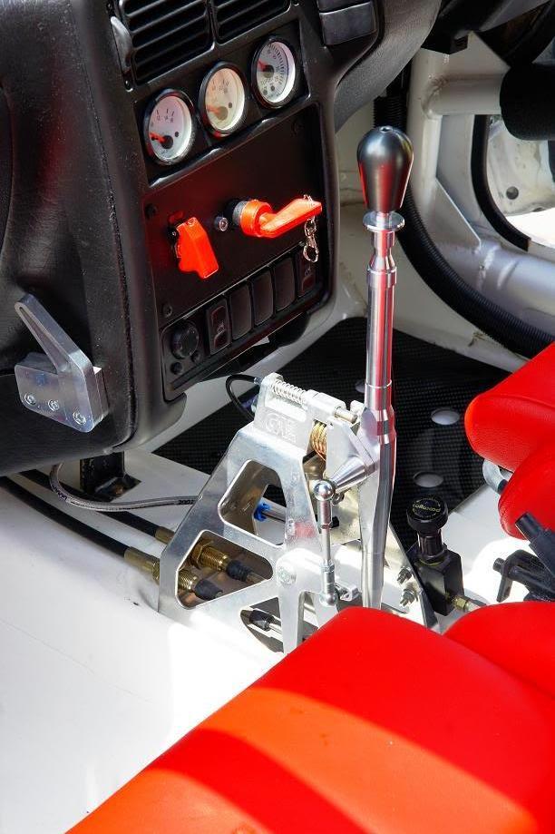

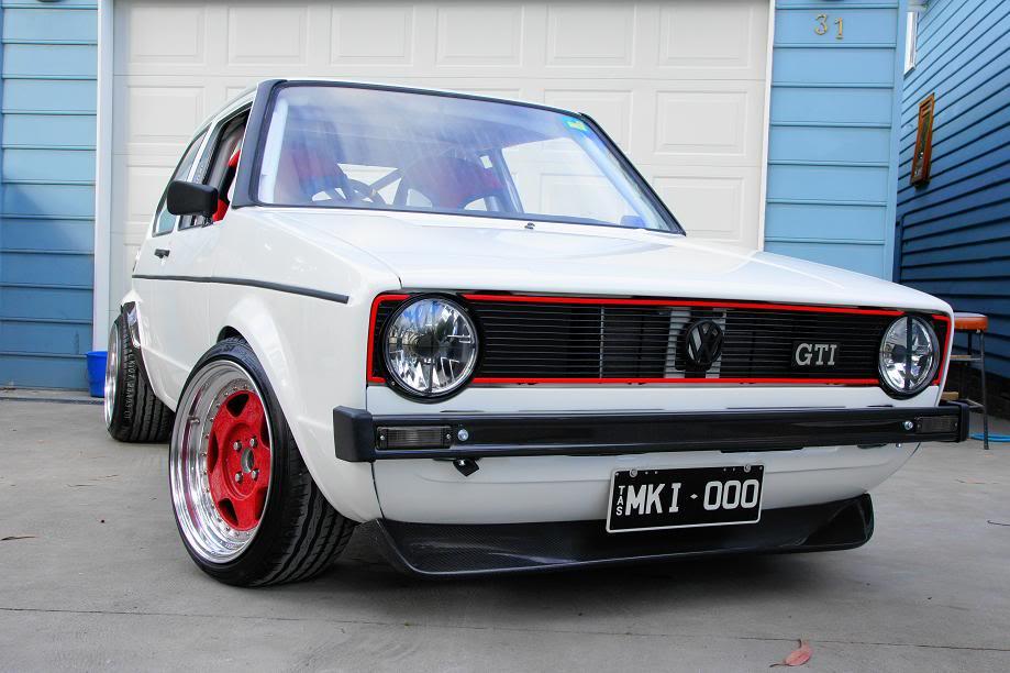

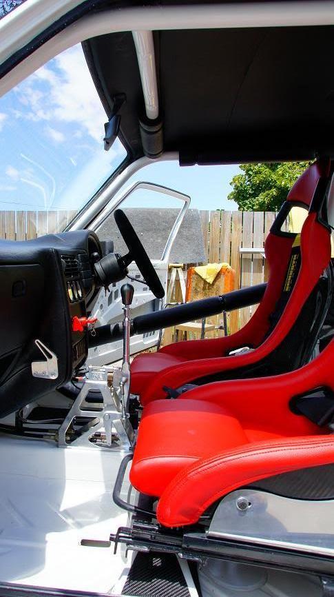

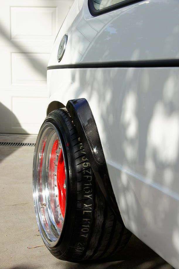

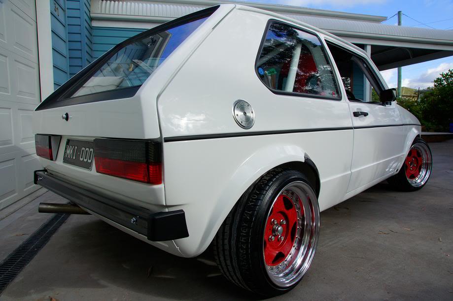

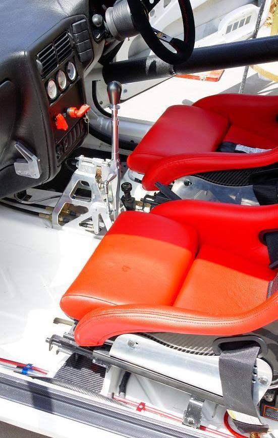

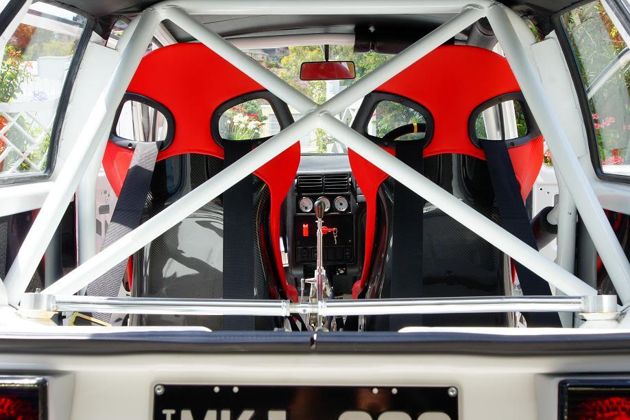

                    I still have to paint inside the doors, fit the side stripes, badges and remaining carbon trim etc, but these pics give some idea of how the car will look when finished. Enjoy
                    • SEX ON WHEELS !!!! Alot of hard work went into the car, and it shows. Really want to see this bad boy in action.
                      • sexxxxxxxx
                        • Wow thats off tap
                          • Gauranteed a future PVW feature car, should be a cover car! Awsome work!
