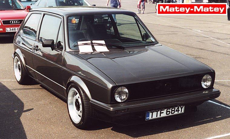

i have noticed a lot VR6 BBS wheels going cheap on the forum over the past 6 months or so...how hard would it be, or would it be worth my while to pick up a cheap set and get them welded and re-drilled for 4x100?
i think they would be a practical wheel and look great on a MK1...or should I just save my pennies and get some ATS cups? (my favourite mk1 wheels) lol

NO, I'm pretty sure it would be a nightmare to do, and not worth the effort to do all that. After all they're only 6.5" wide, and et43, both aren't too flash for a mk 1.
where as ATS cups on the other hand, 7" wide and et 20 or 28, much better option!
Try and find a set in 8" wide, that would be phat!

ahah the car is my daily and i give it the beans and take for natio park runs frequently...i dont want to worry about scrubbing or taking all my fat girlfriends in the back
because the car is not setup for just stance...would 8 wide give me this problem? or would 7's be better for what i'm doing?
http://cgi.ebay.com/ebaymotors/ATS-C...Q5fAccessories --> hmmmmmmm! i want.Last edited by dubmc; 08-06-2011, 12:04 PM.78 2-door 1.8 KR 16v - twin dellorto's
yea, you might want to pass on the 8" wide, but it's still doable.
a 7" with a nice 195/45 would probably be best. You'll need an ET30 or less, (but generally only as low as ET20, and even then, might have slight rubbing issues, depending on ride height, rolled arches etc etc.)
