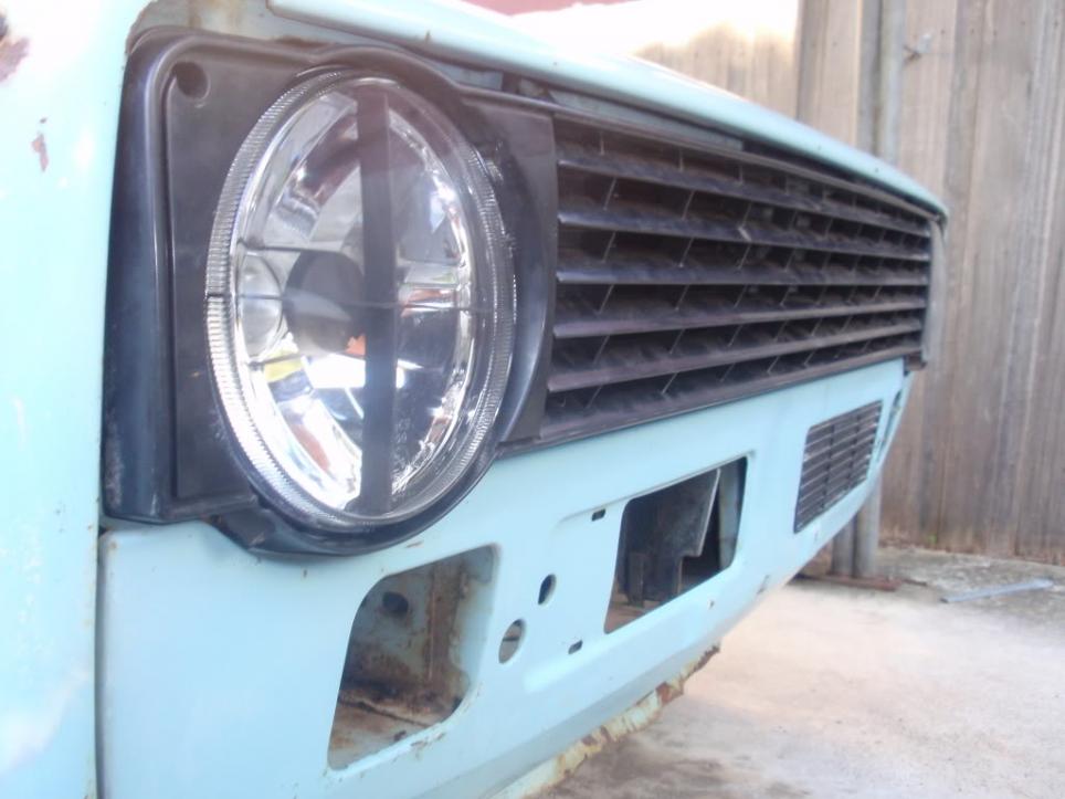

rubbed back the silver paint with a 800 W/D ... then used a plastic primer.. then 3 or 4 coats of plastic auto paint... matt black
primer cost 16 bucks.. paint cost 16 bucks.. 2.50 for sand paper..
i used same method to re paint mirror and bumper caps.. and eventually black plastic interior. Everything from autobarn

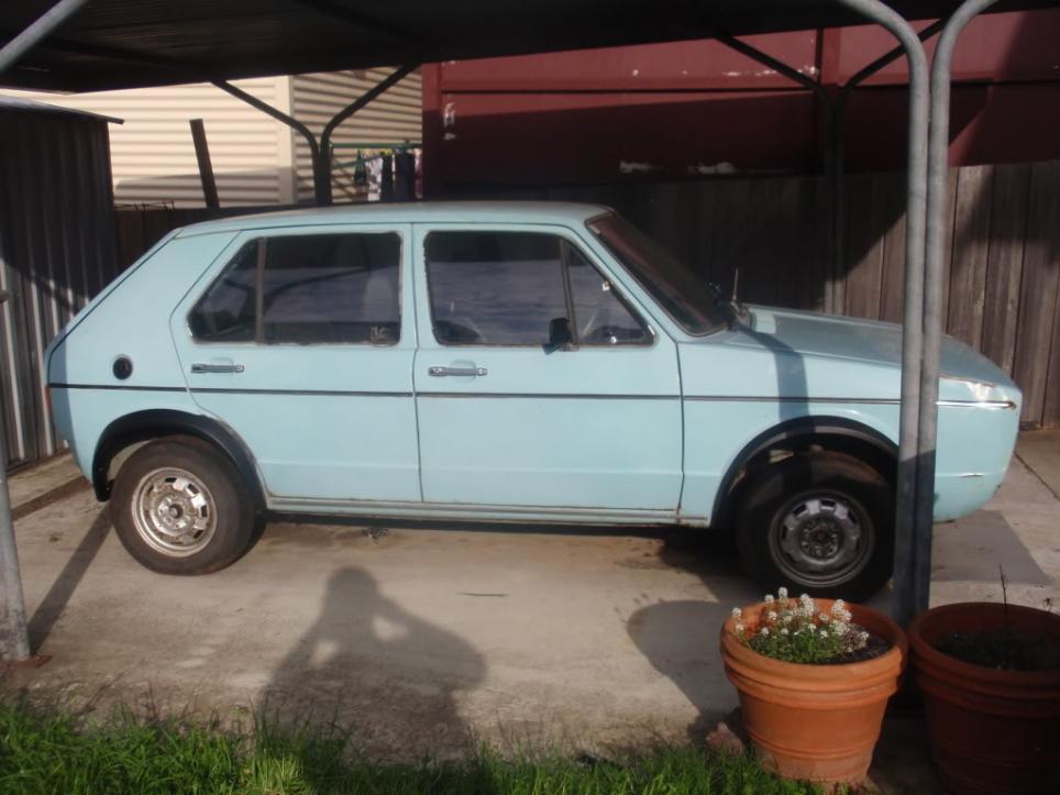

If you have a look at the full right side profile, you can see there is black stuff under the rear wheel arche... that is LITERALLY tar!! one of the previous owners obviously tried to fix up a rusted area, and failed.. hahaha i broke 3 drill bits drilling the hole for the last screw... GRRR. going to have to grind that off before we paint!2012 Ford Focus - Panther Black

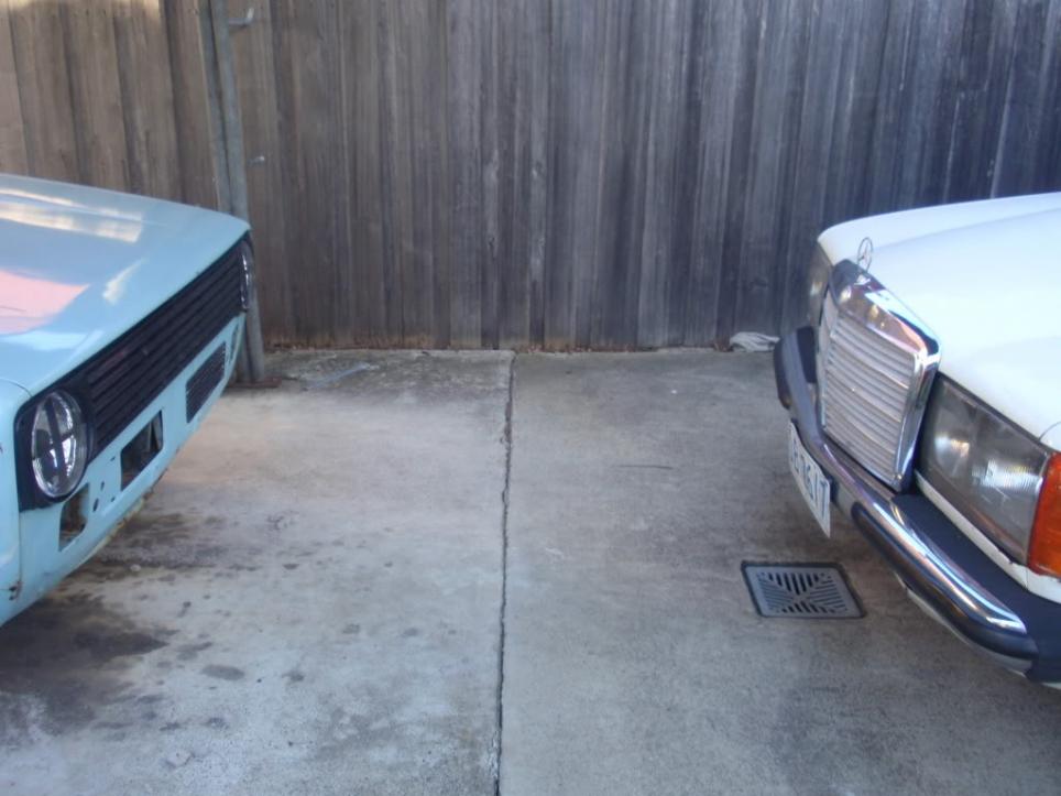

Got a new badgeless mk2 style grill and a dashmat of our boy dan!
HEHE my mk1 meets the current daily
