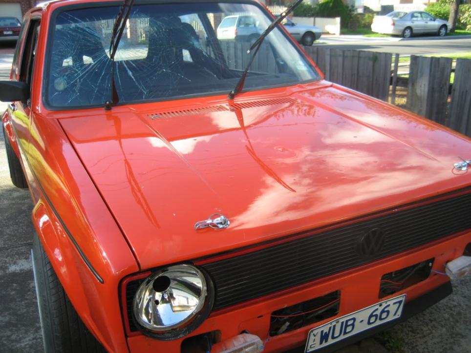

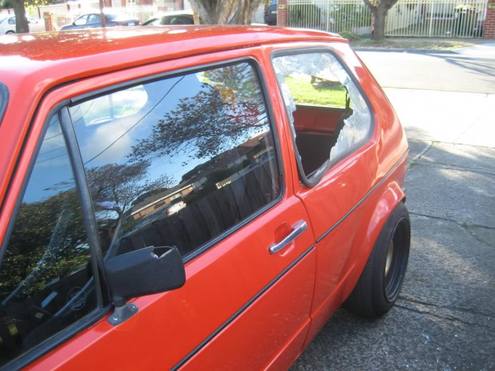

        Yeah i guess im pretty happy that the parts are replace able and i actually have half of the parts already. Im lucky my new fender wasnt on yet, and my HID's actually didnt break, they just got pushed in so im pretty happy about that. I've already changed the rear quarter window, however the front is a problem. The seal seems to be siliconed on, and the more i move it the more it breaks. I think ill need a new front seal.

              Just concentrating on replacing everything for the time being to get it ready for the SW meet. Does anyone have tips of how to take off the windshield seal without tearing it, as i think the suns f*cked it. Where can i get replacements, or how can i take it off without breaking it.. i think its been siliconed on?

                    spray it with windex to soften to seals and then sit inside your car and using your feet apply even pressure on the perimeter of the glass, its laminated so it wont actually break anymore so long as your careful...had a windscreen bonded in and got it out this way

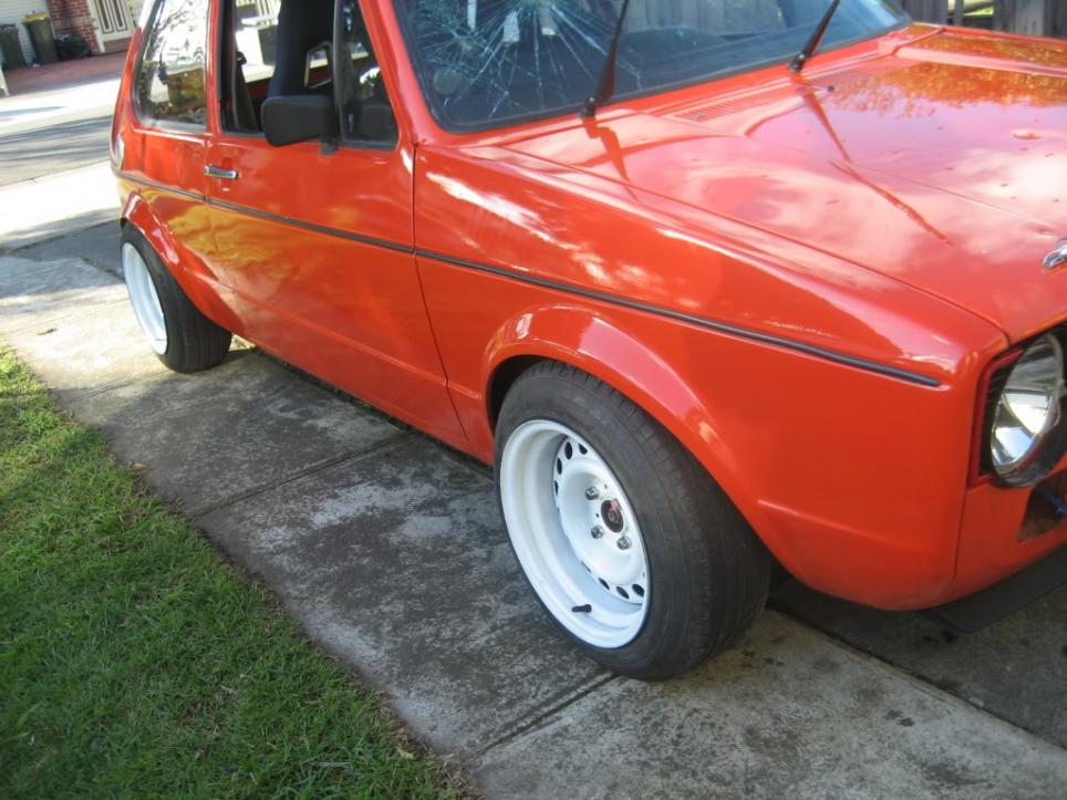

                      • Those rims are sweet
                        Much better then before, love it

                          Hey dude thanks for that it helped a fair bit actually. But i still had to cut a tiny bit of the rubber off as it seemed to be glued/melted off?
                          I managed to put the windshield in but it still a bit wonky and moves around a tiny bit. When i drove i noticed air still getting in. I can only guess that i needed to silicone it in? Ill add silicone tmoro to stabalize it, my mate said that all windsheilds are siliconed on but i've never had to do them before and this is my first window transplant i've done..
