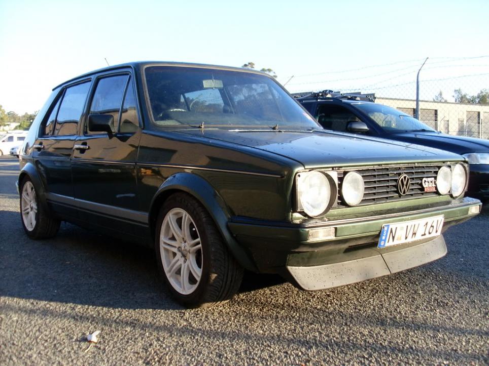

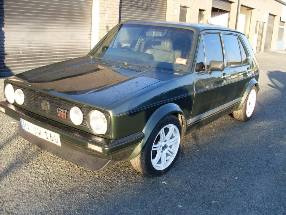

Put the bonnet back on and gave it a wash. Took some pics and put it back to bed.
Better Pic
