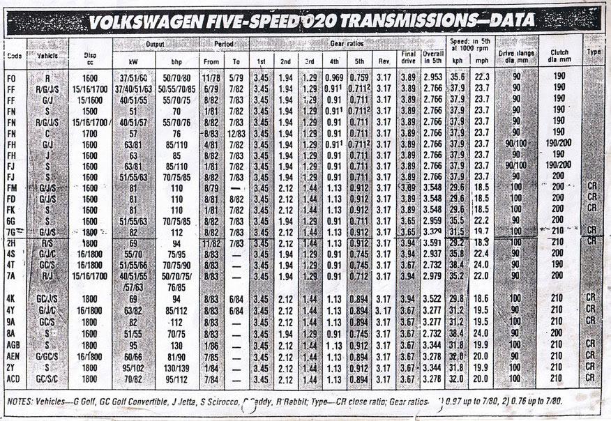

Hi guys,. I'm looking at getting a 5 speed for my GLD, but I'm not sure which box and ratios would be ideal.
By my thinking:
a 4T (longest ratio) would have the car sit at low rpm at freeway speeds, but be a little bit sluggish around town, cause of the longer gearing.
oposite of that would be a close ratio box (GTI boxs') will still sit at reasonably high rpm at 100, but the closer ratios would make it zippier around town.
Ideally, a close ratio 5 speed GTI box with a 5th gear swap (for a .71 as opposed to a .89) would be ideal. An FO, FN, FH, FJ, FF has this 4+E (overdrive) 'feature' standard.
Comments? thoughts? and what about mk 3 boxes, what codes do they have?
for reference:
TIA
