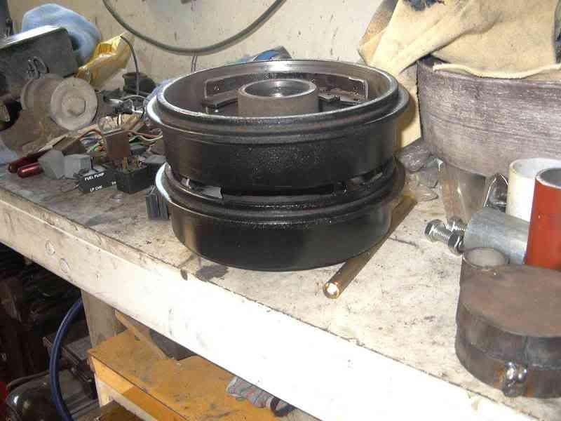

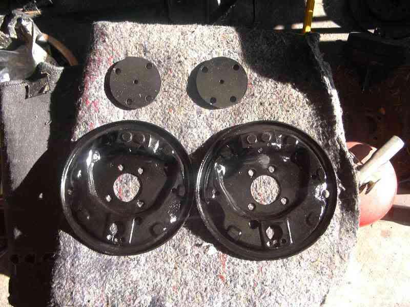

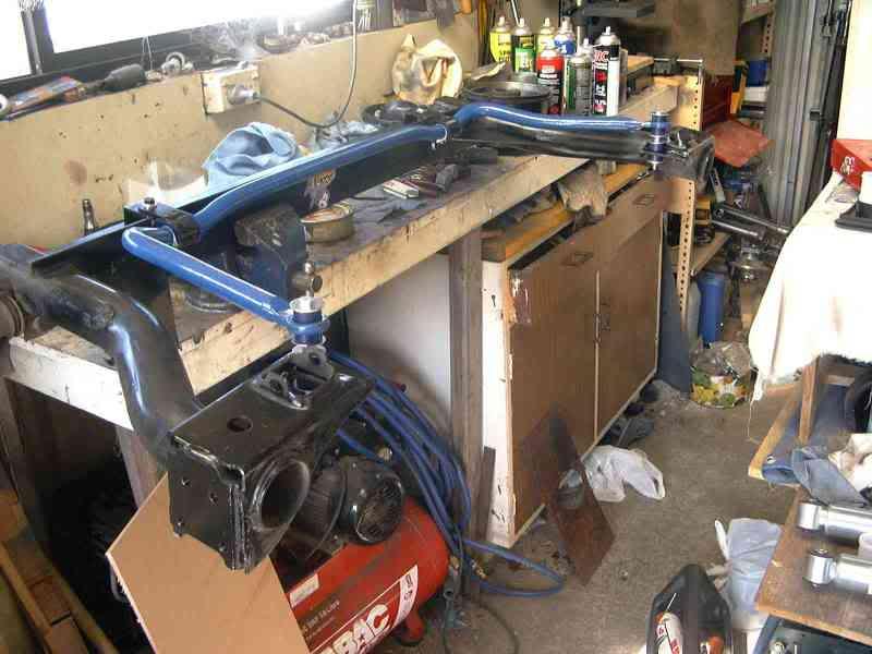

        Update time - rear sway bar mounts completed and 26mm Jap sway bar now bolted on - see if you can guess what car it was from (it was a front sway bar on the doner car)
        Rear brakes cleaned and painted ready for installing - the smaller round discs above the backing plates are 12mm thick rear stub axle spacers

            Thanks Andrew - the beast won't be that low realy, I like suspension travel as it saves on kidney transplants, I will need a replacement right rear brake line though due to suffering a rooted bundy nut on the slave cylinder end.

                        love the magna sway bar idea.
                        how did you go with the mounting of it? [the mounts more specifically] Looks like you've used new bushes aswell, are they magna or golf items?
                        • #27
                          Bushes are 26mm universal Poly sway bar bushes (can't remember the brand), for mounts I've used the original Mitsu****ty units as a starting point and cut/lengthened them to suit the MK1 beam. Both retaining bolts have high tensile nuts welded to the backside of the mounting holes to save the grief of trying to hold a nut on while I tighten up the bolt. The only thing that needed a little thought about was how to attach the eye end of the bar to the rear beam, a few pieces of 5mm thick flat bar fixed that along with a few gussets and a little welding - I'll take a few close ups on the week end and put them up here.

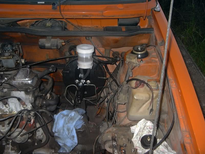

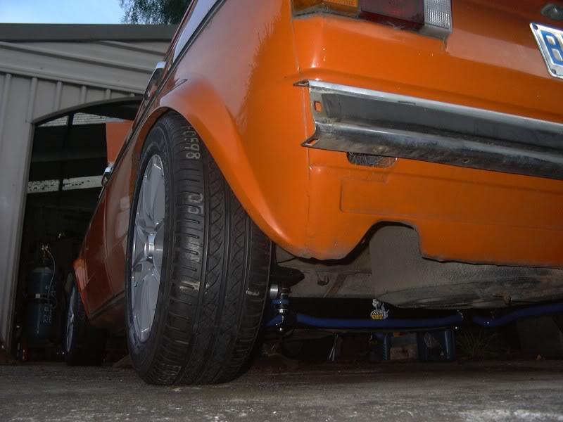

                              Update time -been a while but work gives me money if I attend - all helps get a little more done on the orange beast:
                              Now on wheels with low coil overs (low for now)
                              Down we go in the weeds
                              New master cylinder and Cordoba booster
