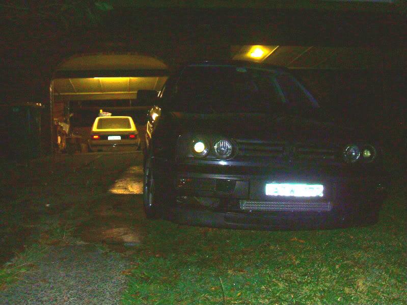

so i fitted a larger intercooler today.... basically just a deeper vesion of the one i had.... and extra 2.5" on the bottom. its a lot more obvious that theres and intercooler there now, but i dont care. im after power and efficiency, and i get enough people trying to race me anyway, i don;t think it'll make much difference to that.
i havnt really noticed any more lag... but i'm hopeful that the extra bit of direct airflow that it now gets will aid in keeping it cooler than before (even though it was working great).
pic (sorry it was dark.... my crappy old camera did little...)

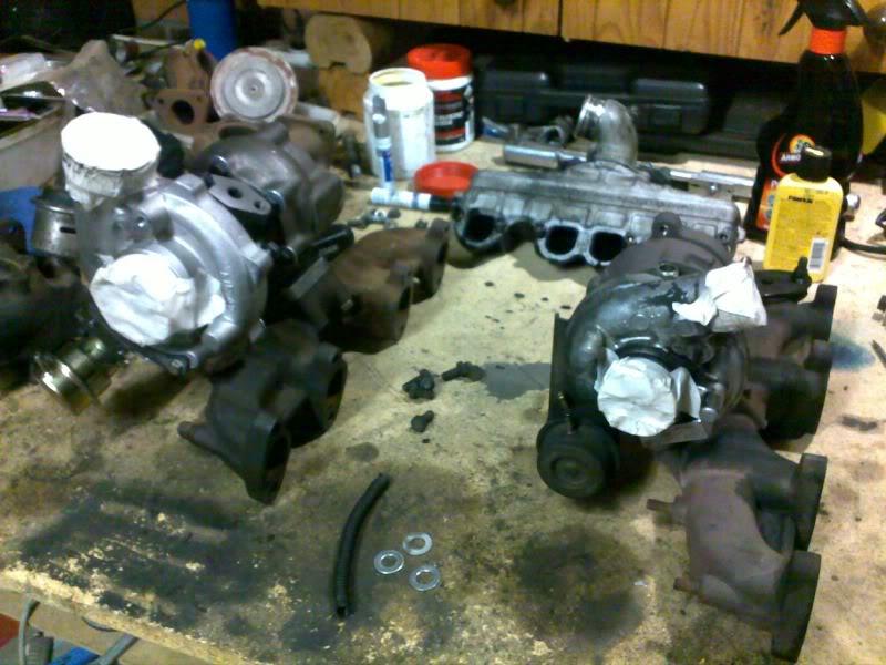

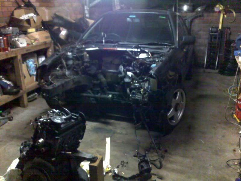

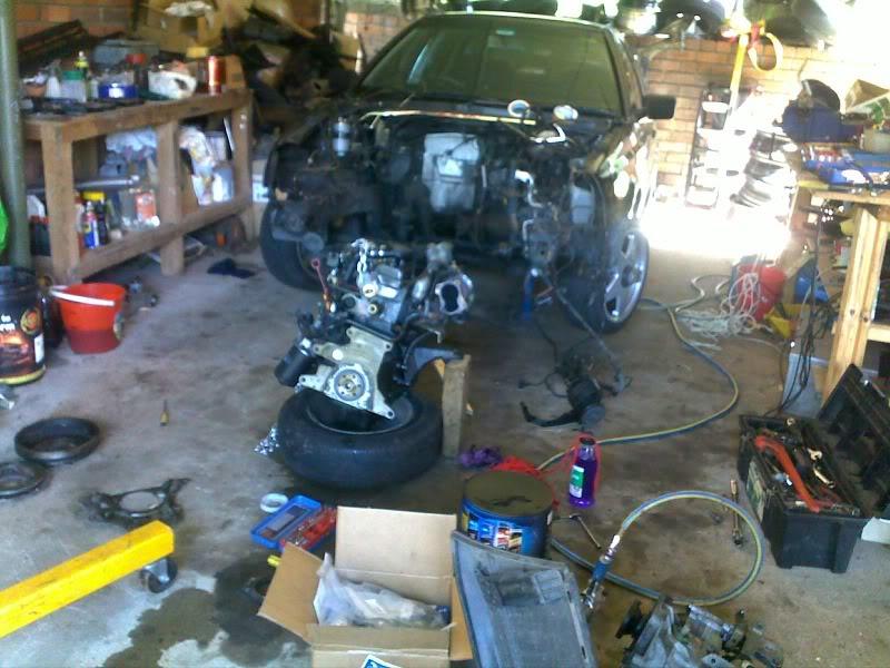

so guys, the time has come... for me to do something.
uni is finished (so far as i know) and the last month has been hectic but wanting to get into all the things i've said i wanted to do for years (literally) has finally got the better of me... i think i'll let the pictures do the talking:
heres my big achievment:

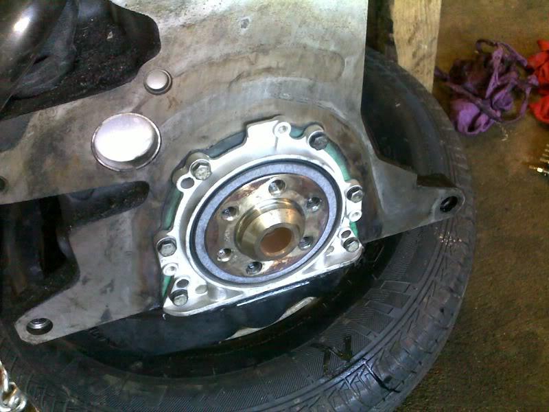

clutch slip (again) has necessitated a new clutch. new rear main seal

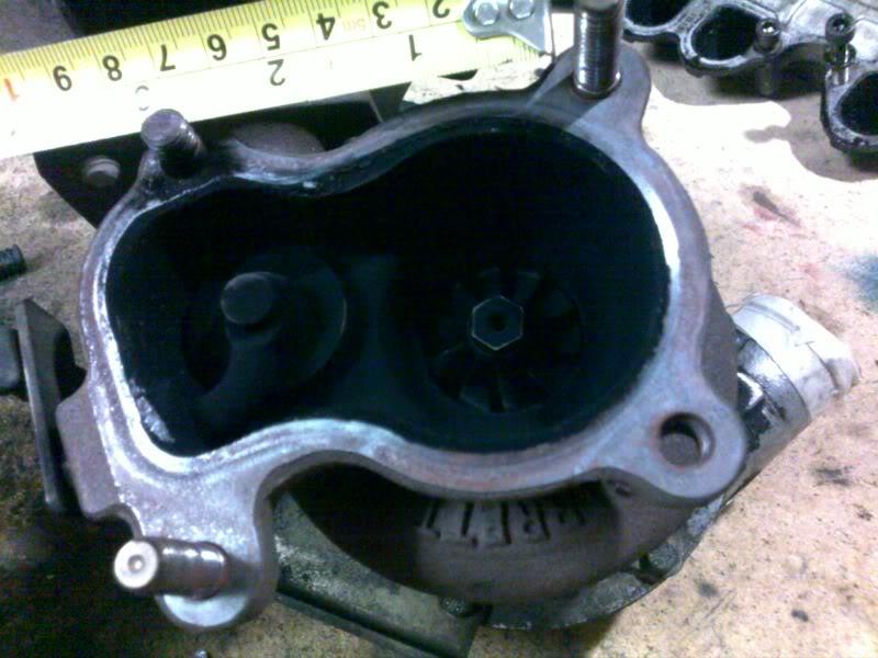

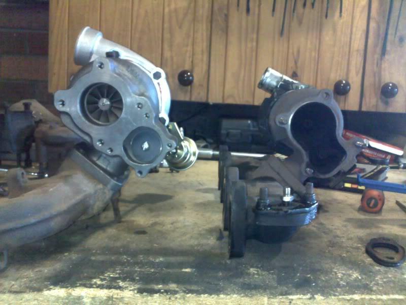

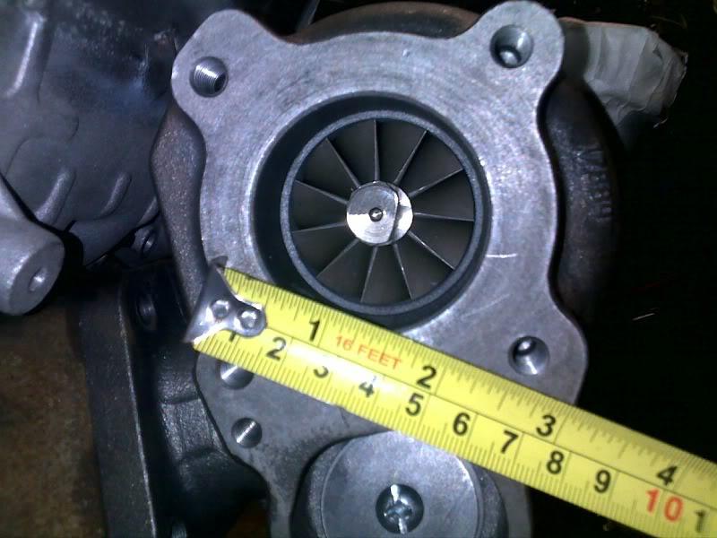

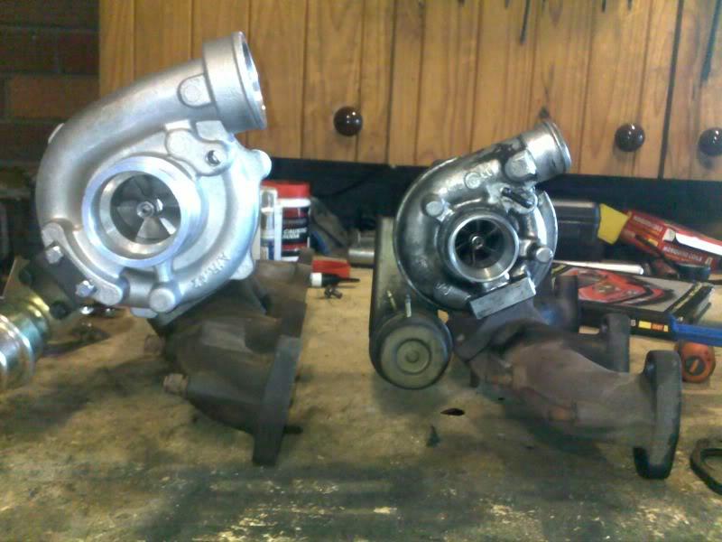

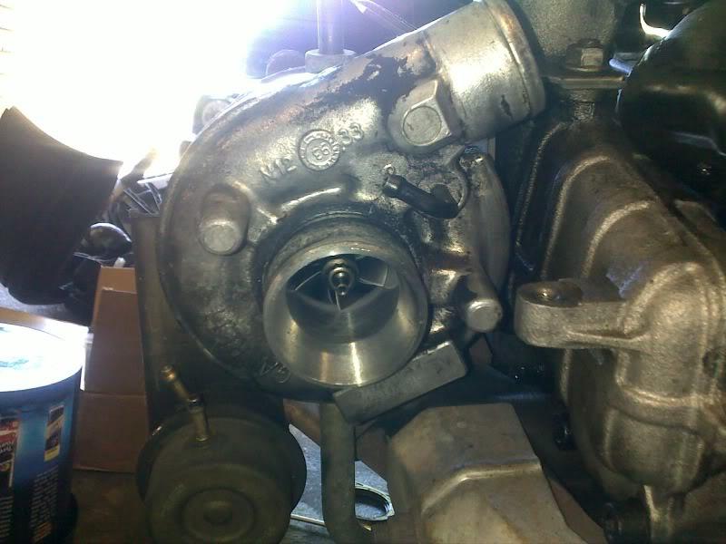

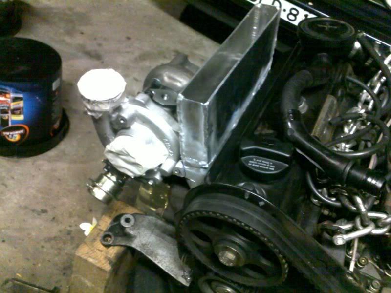

who could believe.... all this time i thought i was driving around a k14 turbo, turns out my brain is fried cos this is a wee little garrett T2 - and its been pushing 22psi for 40,000km now.... lucky i have a big intercooler
but enough with the past, how about this for a size comparison:
theres a little work going into adjusting the positions of the wastegate actuator and compressor housing to clear something else i'm working on this week...

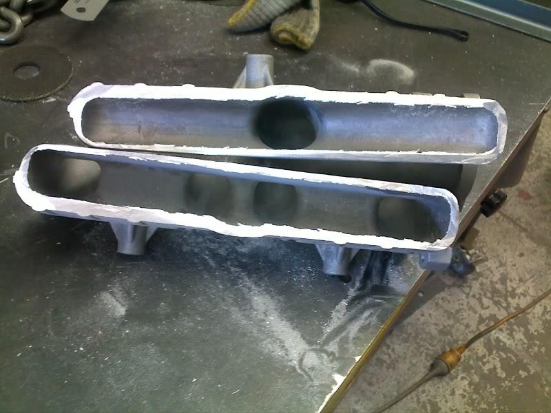

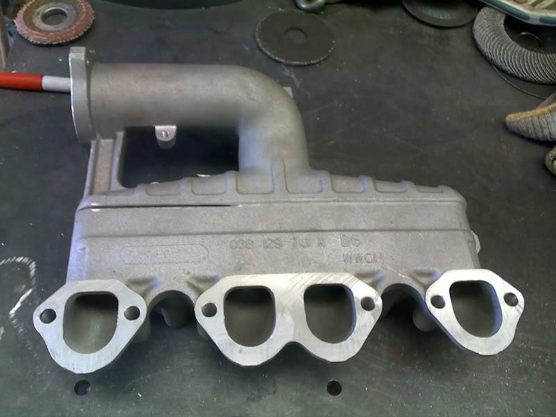

brand spanking 1z manifold....
making the incision...
'98 Mk3 Cabriolet 2.0 8V
'99 A4 Quattro 1.8T
i've got a total of about 20minutes aluminium welding experience, so i dove right on in...

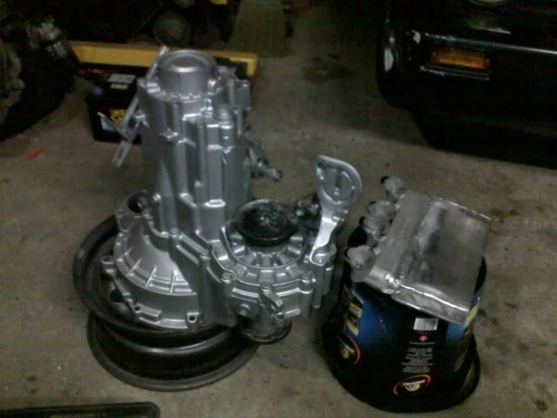

and the obligatory gearbox cleanup...
sorry for phone pic quality...
on the upside, i am hoping to have this thing together and running for this sunday afternoon, just waiting on new oil lines, finish my intake manifold, and install a couple of other new bits while its all apart - gearbox input shaft seal and bushing, new timing belt, new main engine mount, new turbo intake pipe, and modify the exhaust downpipe to fit new turbo.

Great work dude. Who cares if your welds are a bit average.. That's how you learn! Loving it.

That Turbo looks pretty purposeful mate, you could put the old one on a Mk1

ahh, great minds and all that - the T2 will be going into Megans CabOriginally posted by Golf Loon View PostYeah man.
