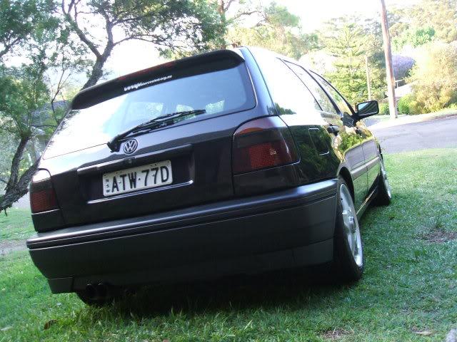

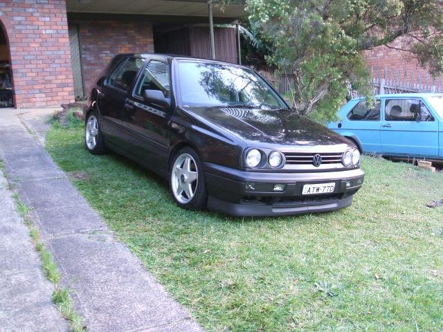

                            feeling pleased, i spent the last 4 hours cleaning her up

                              Congrats on the progress! Hurry up and bash that bigger turrrrbo on it!
                              • #90
                                Bloody looks tops I reckon. love the colour, and it's so clean! (not a fan of the head lights though..)
                                Best of all DIESEL POWER! Good stuff.
                                I would have looked at buying that one in (QLD?) that was for sale, except, I already have 3 cars. bugger.
                                keep up the good stuff.
