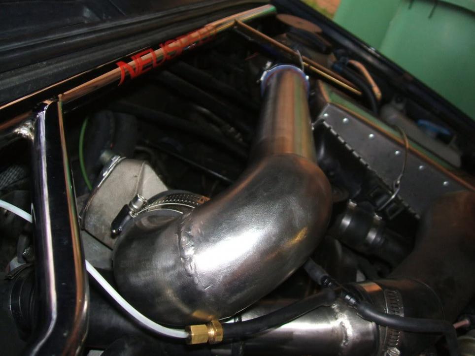

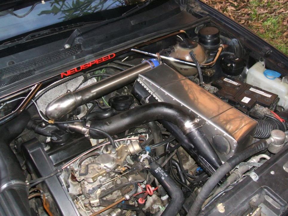

well, a little update,
took apart the old intercooler piping setup in order to optimse it a bit, and get rid of 2 very tight rubber hose bends - and i came up with this....
also, i de-EGR'd the car. after taking off the cast alloy fitting that bolts onto the top of the intake manifold in order to inspect it, i was disgusted to find an enormous buildup of black goo - consisting of exhaust carbon and oil mixed together. i belive this is a trait of the early EGR setups which works very well to gum up your intake manifold.
i made up 2 blanking plates - one for the exhaust mani, and one for the inlet, and then just removed the rest.
i figure that hte exhaust blanking plate will be perfect for mounting a EGT sender, and the inlet one might be good for inlet air temp.
i also found that the intake manifold is grossly goo'd up aswell, but until i pull the turbo off, i cant get to the intake manifold bolts. therefore, it will have to wait - goodness knows how much power and efficiency is lost with all of that goo in there!
