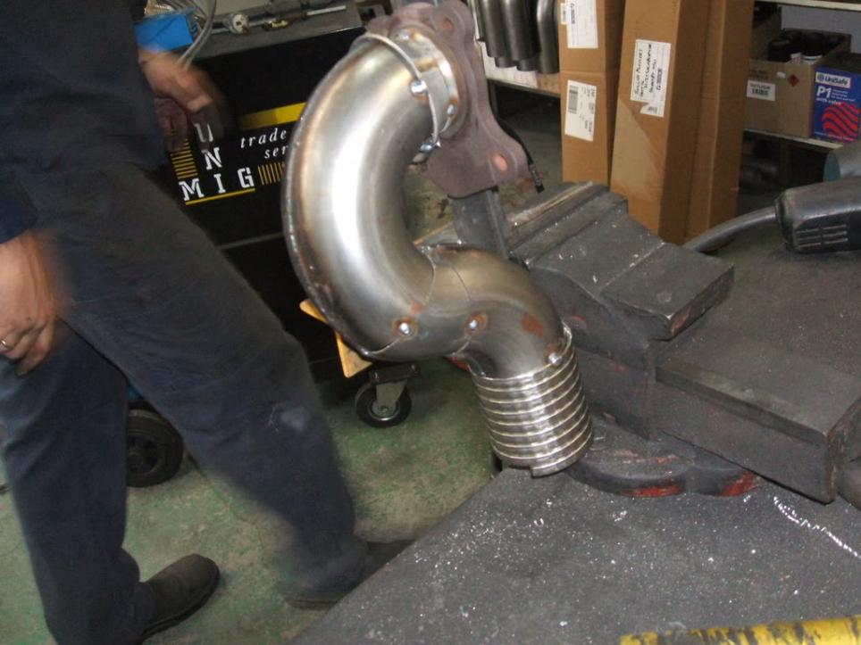

some pics for good measure.... fabbing the downpipe - we made a jig to get it just right and re-used the brackets to ensure its all solid and not putting any pressure on the turbo

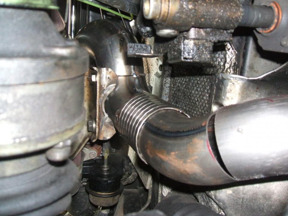

making sure it fits nicely....

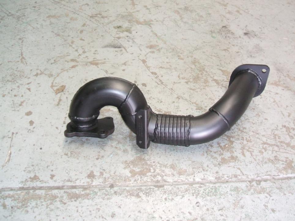

the finished downpipe - aint it pretty?

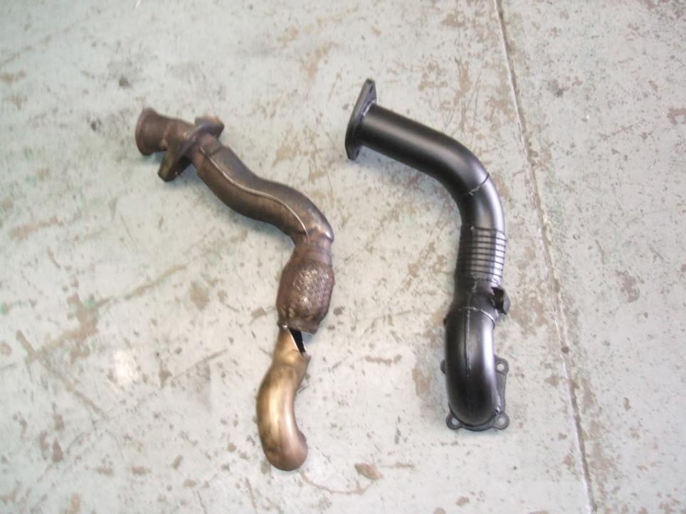

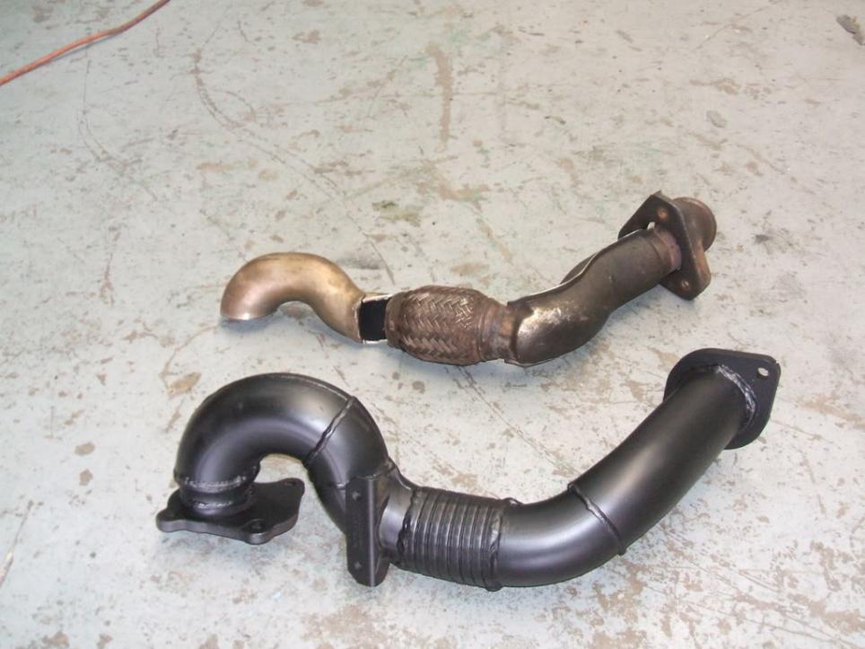

the old downpipe and new side by side

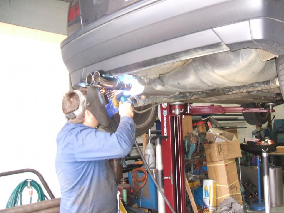

Tacking up some of the rest....

It sure do look purty ............Originally posted by gldgti View Postthe finished downpipe - aint it pretty?
