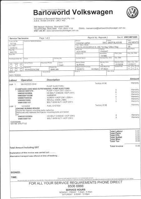

    All sorted and done.
    Here's the service receipt for what was done.
    The tech obviously ****ed up mounting the injectors the first time and that's what the problem was.
    And yes, I know I'm going to be asked. 0 performance increase and the car does not 'feel' any better. Exactly how it was before.
    • #32
      Obviously failed to use correct mounting tools.
      Those bolts are stretch bolts, so if you 'pull' the injector into its seat using the bolts, either your car will not start or will misfire under load.
      Ive measured used vs new and seen up to 10mm difference in length.

              To be honest, I couldn't care less.
              I didn't pay for it, and from this moment on...that receipt makes them liable for whatever goes wrong with that portion of the car's engine.
              The new injectors have a 7 year warranty on them IIRC and the workmanship/parts on the invoice state 2 years.
              If this year and next year is anything to go by in terms of kilometers I do..that will be 100,000km I do in 2 years so if something breaks it's going to happen in the next 2 years.
