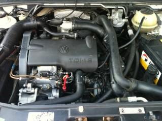

                Stock 1Z motor AFAICS...

                  looks like you have a remote 2nd fuel filter fitted on the firewall left of the coolant expansion tank.

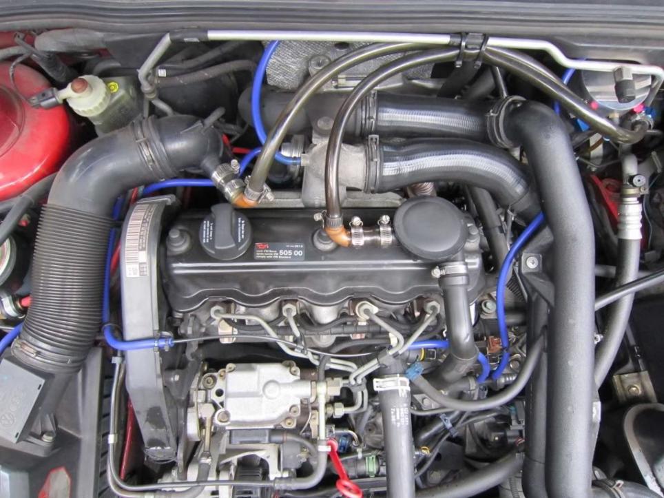

                  That is exactly where I fitted my Oil Air seperator Catch can.
                  I have only see a remote filter on one white auto TDI I test drove about 10 years ago out West of Sydney when it poped up for sale.
                  Here is an old shot of my engine bay:

                        Your engine bay is putting mine to shame, all that armourall for nothing:

                          So does it have 2 fuel filters?
                          Stock on is on Driver side stuck on the front of the Strut tower behind the airbox filter.

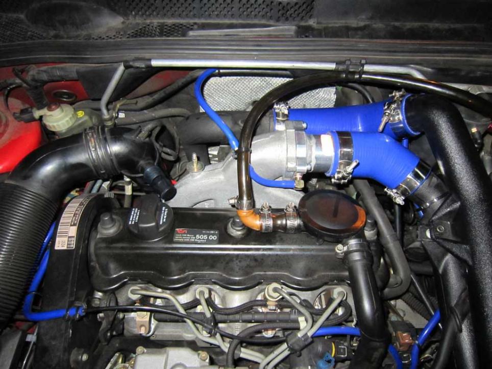

                          Current Engine Bay:

                            Yes, its being coy in the pic, but there are two fuel filters in series.
                            The one in the pic gets fuel from the tank and sends it to a 'Fish John-West-Rejects' filter with what looks like no replaceable parts clipped to the front of the RH tower and from there to direct injection.

                              actiually the John West Filter is The Stock Filter. It is a complete Unhook hoses and replace job. Kinda nice since less diesel is spilt and you have less chance of contaminating the fuel. It also has a built in water tap at the bottom (Which you should open up and let a bit out every oil change) The Mk5 has a drop in filter element with no water trap!... I can't wait till I have to replace that and get my hands all dirty - And it costs the same about $65.00.
                              The 2nd fuel filter is a spin on cartrige filter. Basic spin on filter type maybe Ryco or eiven a Toyota or Nissan job alot of 4x4 put them on if they dont already have one as they use them as cheaper pre filters. You can get differnet filter cartriges maybe they make one down to 2 micron. IF you have a 30 micron on then it is not realy doing anything but catching sand! you want about 10 micron filtration.
