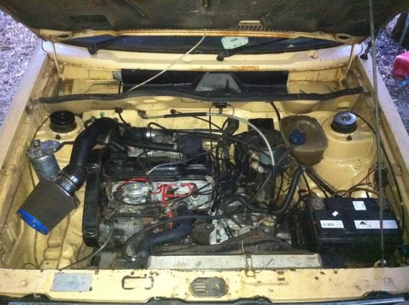

              Well its done, and not without a bit of nostalgia for the ol 1.5D donk. It has (and still is) a very good motor and is a perfect pairing with the chb cordoba gearbox.
              Out with the old
              And in with the new
              I used the back way to get the motors out and in.
              My helpers.....
              Install complete
              Things to do now include:
              replace gearbox drive shaft seal holder (the green sheetmetal one) as its damaged and leaking
              install washer bottle - I have a petrol washer bottle and mount to go behind the battery
              source and install a cordoba air cleaner box (thanks mollins for the idea)
              wire up reverse switch
              mount fuel filter
              mod alternator to run the tachometer
              exhaust
              intercooler
              egt etc etc.......
              The car pulls really well in 2nd and 3rd. In 4th and 5th it isnt brilliant but has a very laid back feel. Boosts to 10psi
              Beige 79 Mk1 GLD White 76 Mk1 LS 3 door
              White 68 Alfa 1750 Berlina Champagne 91 Alfa 75
              Red 09 9N3 Polo TDI White 2010 Skoda Octavia Combi TDI
