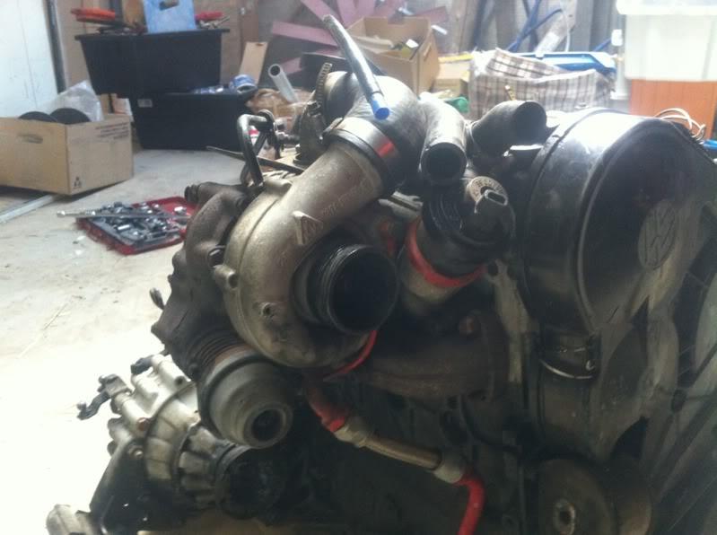

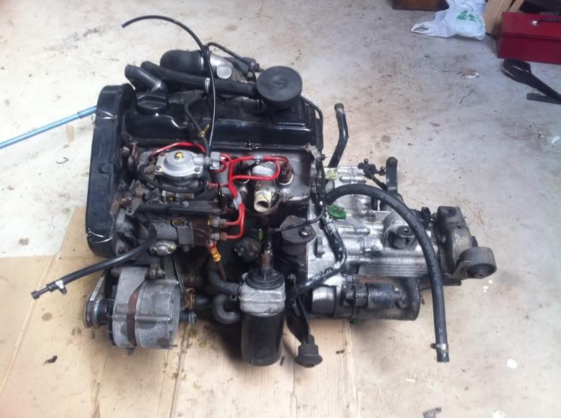

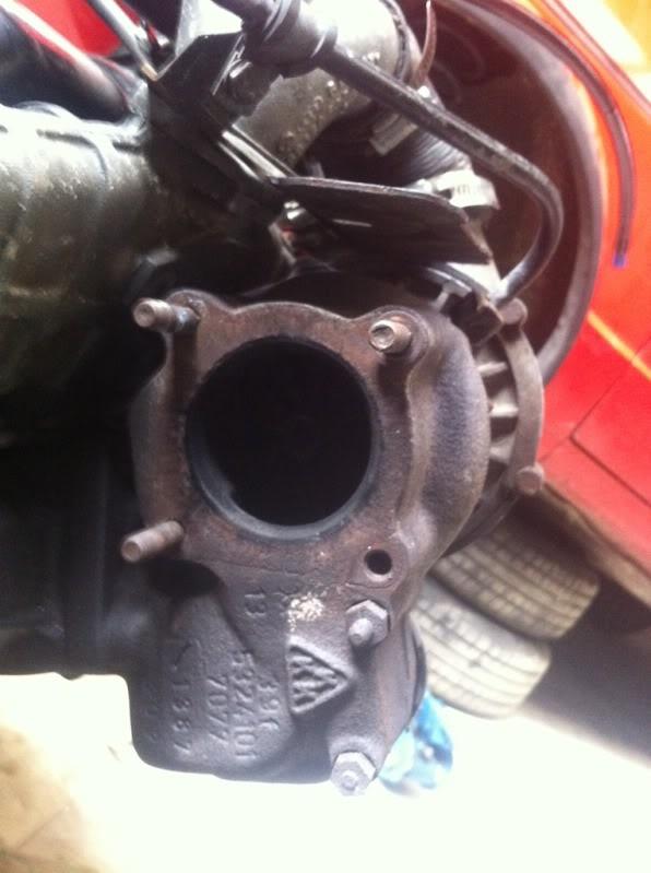

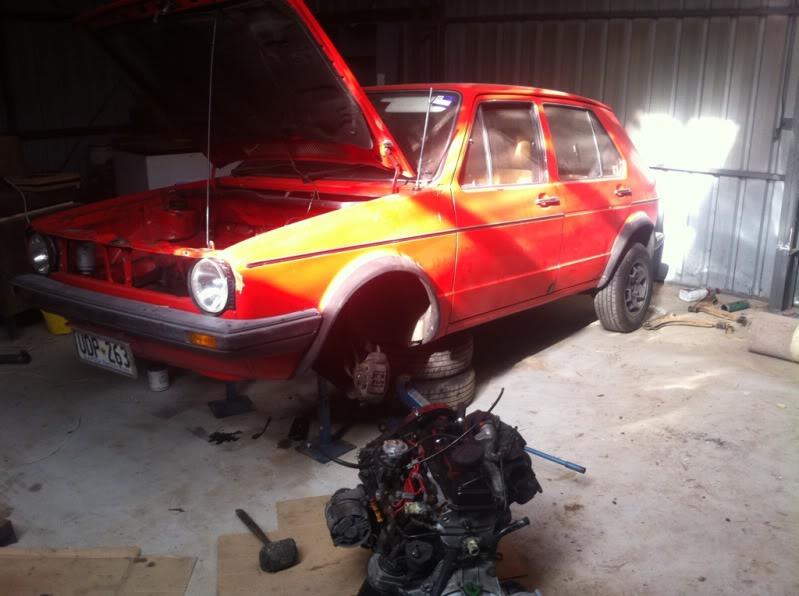

                    Engine is out
                    This motor has a k24 turbo, which is big. I will probably swap it for a k14 as I have a couple of these spare.
                    I noticed when removing the drive shafts that if I turn one flange, the other turns in the same direction. I can get the other flange to turn in the opposite direction only if i put it in gear (and theres a bit of friction to overcome). Does this indicate that there is an LSD in there or just that the spider gears are stuck? I will replace the flange seals as they are leaking so I might be able to tell from that..... Gearbox code is 8A

                        Hey Ayden, this motor is very sooty when given a mild poke off idle (in neutral). It pulls well up to around 80km/hr then it seems like when the turbo is producing boost (maxes out at 10psi) there is no more fuel. Any advice on where to start with tuning this motor would be appreciated. Before i do too much I will install an EGT gauge that I have here, plus an intercooler and 2.5" mandrel bent exhaust. I just need to fab a downpipe as the standard unit would make a good funnel (2.25" down to 1.5"!)

                            Hey mate,
                            The diff doing that is normal, dont worry about it.
                            Your pump looks like a good one, it should have a proper boost pin and the adjustable spring seat for the boost diaphragm in the pump top.
                            First thing I would do is turn the fuelling down a little bit, then adjust the boost pin to the most agressive taper. Theres a lot of things to adjust but without seeing it running or driving it its difficult to make a good judgement about how to tune it.
                            If you find the governor is cutting in in a really big way, then i'd look into doing the gov mod. just shim the main spring in there with some little washers or a M5 nut or something.
                            A K14 will be really cool in the mk1, but the k24 should give you better performance if you can tune the pump to deliver the fuelling well and have a good exhaust so help the spool up.
                            Anyway, 10psi is not enough - you want at least 16-17psi and more with a good intercooler setup.
