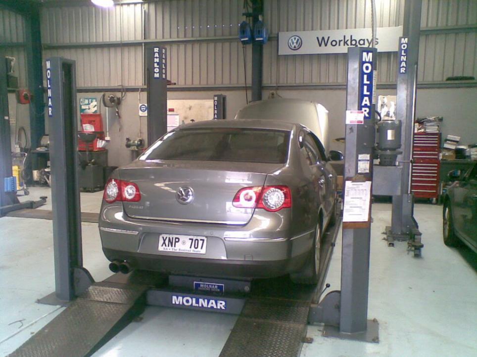

Thought that since I had a 2007 Passat TDI, with the 103 KW motor I would be safe from adding to this threat, but alas no. Final day of our holidays, 20 KM’s out of Geelong on the Ballarat road, cruising at 100 KM’s, engine management light comes on, then the engine dies, thankfully still have brakes and steering. Being with the RAA in SA, can ring the RACV for a tow, no problems, explain my location from the GPS. Phoned a VW dealer in SA for help in locating VW dealer in Geelong, promised a phone call back with the info, still waiting for that call back. Phoned my daughter to Google it, had a dealership in minutes. Tow truck arrives, advised that I need the car to be towed to Rex Gorell which I had already phoned to advise what has happened to my Passat. An hour after we arrived, the bad news, injectors and wiring loom need to be replaced, $3500. No worries he goes to me, VW expense, but need to order the parts from Sydney. RAA puts us up in a hotel for 2 days and we walked all of the CBD of Geelong till the Passat was ready. The only strange thing with the car leading up to the failure was that the cruise control was not holding the cat spot on, it varied the speed by around 5 KM’s. Since getting the Passat back it does not seem to have such a rough idle on slow speed anymore.
Baby waiting to be fixed,
One of the interesting things I picked up while waiting for the Passat to be fixed, just about made it worth while,
