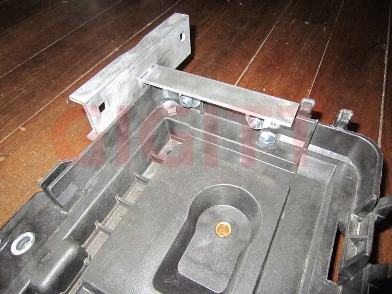

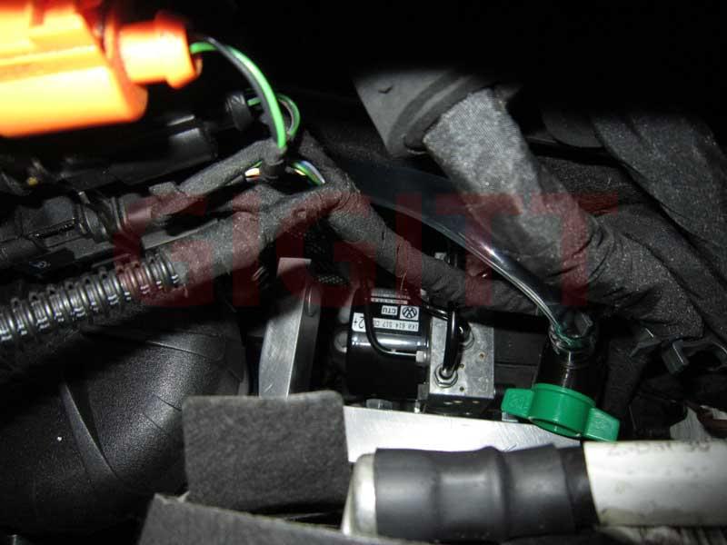

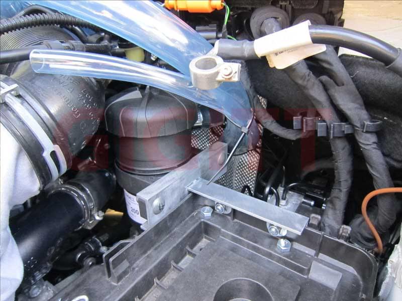

                  Anything will fit!!!
                  here's mine mounted to the back of my Battery Tray:
                  Also the filter does not have to be replaced every 10k km but probably 50k km. so putting it where I have, only means uncliping a few sensors above it. I think it is harder to get my oil filter out the way it is stuffed in there!
                        Nice Job!
