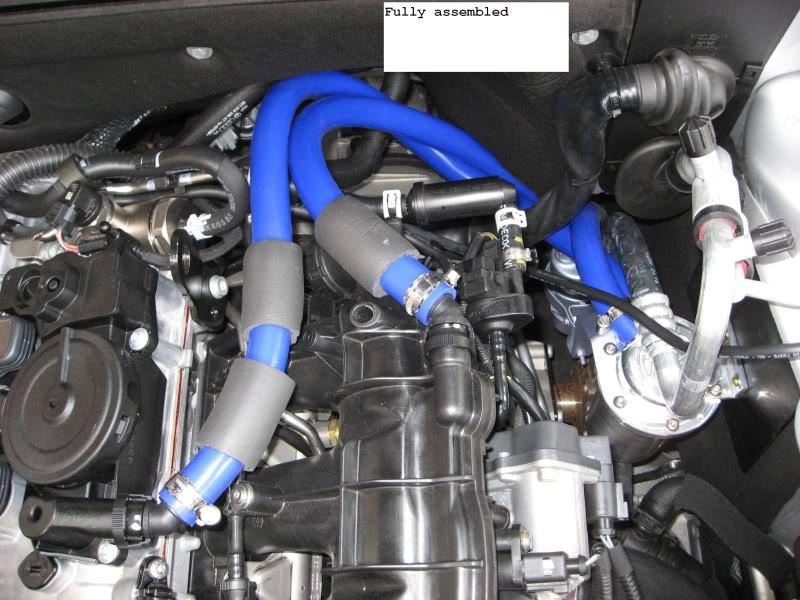

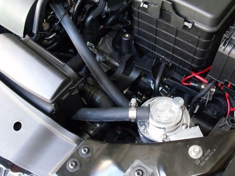

        Things are progressing!
        Audi A4....
        Golf R....

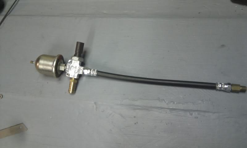

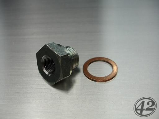

          Recirculation system for Provent drain.

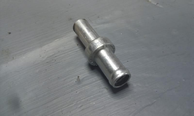

          I've had this running for a few weeks now with zero problems. The Provent drains through a Mann and Hummel one way PCV valve ( which is awesome compared to a few I've tried ) into the 42DD remote block, where it drains back into the sump on shutdown.
          Oil pressure seals the valve when running, and the Provent runs as per normal. As it only collects a few mL per day there's little chance of overflow in a normal 1/2" drain hose. When the oil pressure stops, it drains down into the block, and enters the oil filter.

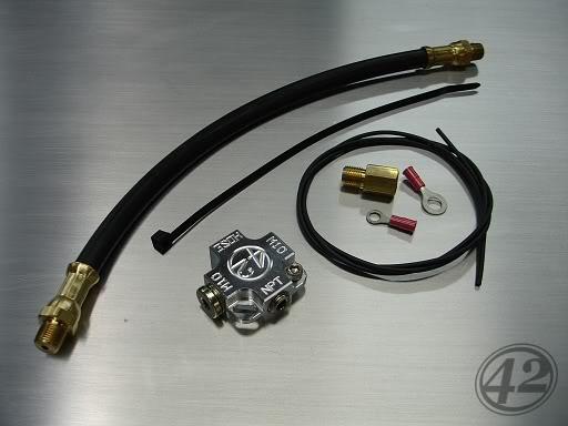

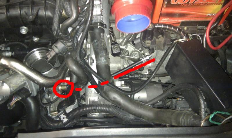

          There are one way valves to keep oil in the filter for next startup, so I'm monitoring the line to see if it does indeed drain. So far it looks fine, but I'll let it go another few weeks before drawing any conclusion. I've added my oil pressure sender to the block ( the bell on the left ), but it comes with blank plugs, so you would only need two ports for a normal drain, with the oil entering on the bottom, and the stock pressure sender in the top in the following picture ( the remote hose taps in where this stock sender bolts in ).
          The VW oil filter is never full on checking, so there is always space for oil to drain into, but obviously this will only work if the Provent is above the oil inlet back into the filter housing. It would be simple to plumb this into the sump drain plug using the 42DD oil drain bolt with sensor adaptor, but that would be a bit more tricky as this gets in the way at service time. Still I have my temp probe down there, and it's a minor hassle at best every few months. Obviously you can only replace the washer on oil change, but I've yet to have a problem doing that for about 50k now.
          Will keep you all informed, but very happy so far, and zero mess!!!
          ( Sorry aboput the pics, only had my phone on me at the time )
