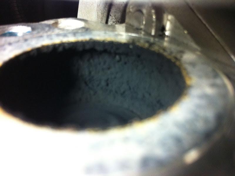

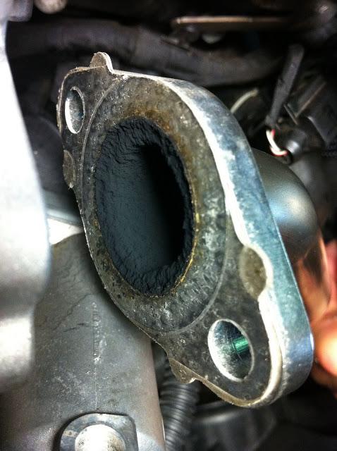

    I just had my 90,000 service and I got my mechanic to do have a look at the EGR and EGR pipe. These are the photos he sent me.
    This is the EGR valve (sorry for lack of focus) and I thought it would have been thicker.
    This is the EGR pipe. Man that **** is thick!

            I hope you haven't misunderstood me Greg. I haven't been ignoring it. I've tried to be proactive at every service, asking for a clean, using the wynn's spray cleaners etc.
            Also a proper picture of the EGR problem has only been made aware to me for under a week. It's beginning to throw engine error codes so it might fail quite soon. Also I'm thinking I might go halves with them in terms of cleaning it up.
            Furthermore I calculate my l/km every week and over the life of the car it's barely changed nor does the car feel slower.

                  No it's cool mate, I'm just wary of anyone discrediting a very real and possibly expensive problem some second owner could inherit. The GT would have to be a desirable car for a P plater for instance, and imagine getting one and the EGR valve or flap goes at over a grand each or the DPF dies, and we know the nightmare cost there!
