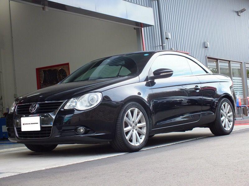

        Hmmm, seems like the Bilstein B12 Pro Kit may be the way to go...
        Seems to be a similar ride height to what I'm sitting at now on the stock springs.
        Need to keep an eye open for them on sale now.
        イシカワエンジニアリング スタッフブログ:EOS 2.0T * BILSTEIN B12 PRO-KIT
