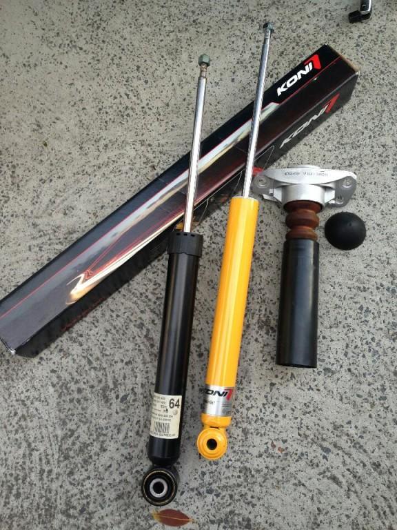

        Ive got SPM lowered springs in my Mk6 GTI and ran them on the original shocks for a few months. After this time i purchased Koni Sport adjustable shocks (the yellow coloured ones) and the car feels much better than it did on the original shocks. Perhaps the Bilsteins would have been better, but i got the Koni's through a contact at my local suspension shop for a good price, so i went with the Koni's.
        Ive used the Koni Sport shocks in other cars previously and never had any issues with them.

                  I was quoted around $1,400 for the Bilstein struts or around $1,000 for the Koni's. The Koni's were already overkill for what i wanted so i just went with those, and got new strut mounts and bump stops etc so that everything was new.
