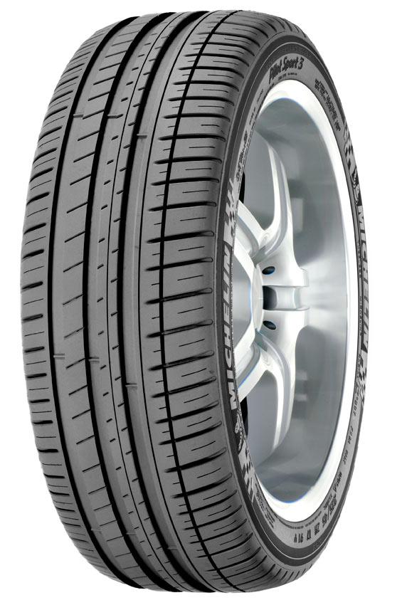

Tempe tyres are doing the Michellin PS3 for ~$240 each - they would be my choice2012.1 Skoda Octavia VRS DSG Wagon - Carbonio cold air intake and pipe - HPA Motorsports BBK 355mm rotors 6 pot calipers

PS3 != PSS
You'll find the PSS are a step above. Even the PS2 are a better performance tyre than the PS3.
PSS
PS2
PS3
The differences are quite subtle but one of the main ones (IIRC) is that the PSS comes with slightly less tread depth.

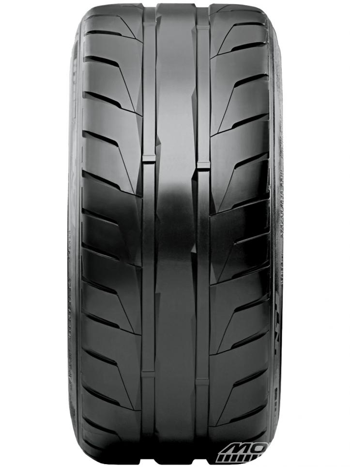

Has anybody used the Nitto NT05??? (I was worried they would not perform)2012.1 Skoda Octavia VRS DSG Wagon - Carbonio cold air intake and pipe - HPA Motorsports BBK 355mm rotors 6 pot calipers

I've been doing some research on the Nitto NT05, looks like they could be a good performer
They certainly won't last as long as a Michelin PS3 but like I said, I want to be able to put the power down
(I really enjoyed the day I had the semi slicks on the car - no wheel spin and soft ride)

The PS3 wasn't a direct replacement for the PS2. It was supposed to be a replacement for the Pilot Preceda 2 & Pilot Exalto 2.Originally posted by sunny View Postwhy PS2 is better than the newer PS3???
The PS3 is better in the wet than PS2 but that isn't what Martin is after. PS3 should also last a bit longer than PS2 - again, Martin doesn't seem overly concerned as he appears to be hell bent on collecting a pair of every UHP tyre available
A few of my mates on another forum have tried both & they reckon that in the dry, the PS2 has the edge on dry traction & turn-in.
So, it depends on what you want out of a tyre & Martin is chasing dry traction from a standing start. For most users PS3 is a great all-rounder.carandimage The place where Off-Topic is On-Topic

The PS2 has a tyre wear number of 220 - which is pretty low - it's clearly a sticky tyre
It was original fitment on cars like BMW Alpina Z8, McLaren SLR and Porsche GT2/GT3 models
Not the sort of machinery most of us are driving
The PS3 has a tyre wear number of 320 - which is still pretty grippy
Based on my wear rate I'm looking at getting 35,000~38,000 km out of them
They do grip well wet and dry, turn in feel and response is very nice
It's a great all round tyre - no question about that
Not a noisy tyre either
