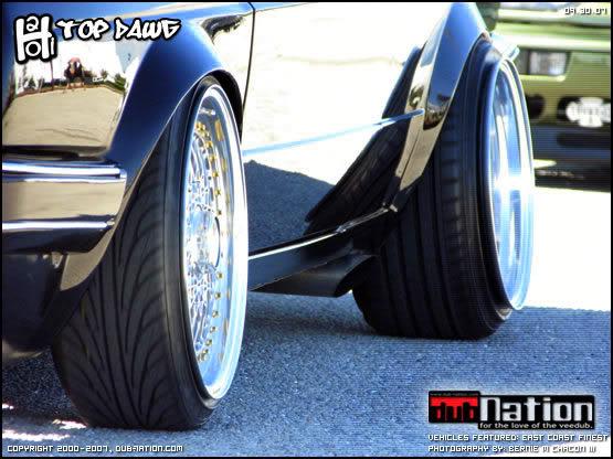

i like what u are trying to do and dont take this the wrong way but i am not sure if u are getting what people are trying to say to u dude. dom is the king of the spring..... if he says it aint gunna fit it aint gunna fit.... if he says it needs spacers it needs spacers. would look cool with poke like this
but it aint going to be easy! goodlucksigpic
