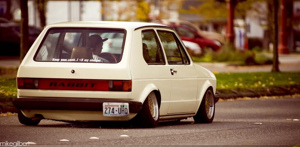

              the work equip and SSR mesh ones will probably look the best Imo. but you'll have to be low to pull off the 'look', otherwise you run the risk of having the car look like an old roller skate
                like this!

                      My point about it being low, was that if it isn't low enough, it'll just look like the wheels dont fit at all. where as if it's low, and you have the arches rolled, and some stretch you'll be able to make them look as if they fit. If that makes sense at all.
                      No point going for an 8" wheel if you want to be super low. but if you want 8" wheels, imo, et25 is a great starting point. (i'm pretty sure I already pointed out the need for fender work, and spacers etc)
