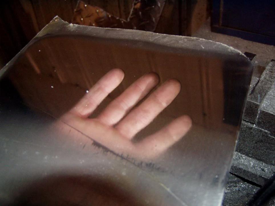

I tip for hand sanding aluminium is to use some CRC 5.56 (WD40) or kerosene (wear gloves..) or even water works well too, as a lubricant for the wet+dry. It stops the abrasive loading up (getting clogged), gives you a better finish and the abrasive will last longer too.
I would have gone to 400 and then to 800 before polishing the spokes, but i guess being a toolmaker i'm pretty critical and pedantic about getting polished surfaces polished properly..

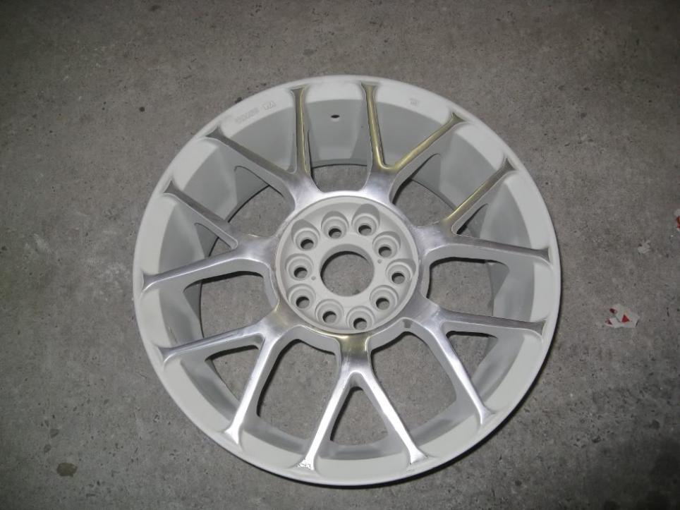

not bad at all Mikey, i'm sure they look a load better in person too! Be nice to see it with painted insides to really bring out the polished face keep at it!

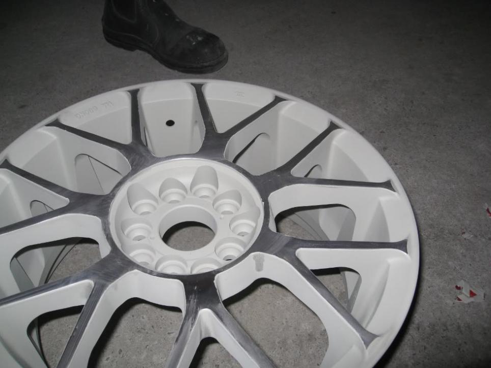

See how it "looks" polished, but notice that big score mark at the bottom edge of the polished surface? This is because they have polished it before it was truly ready. The high points are polished, but all the low points (scratches) still remain in the surface.
Buffers do a great job, but you have to get the surface to an even (and fine) finish before you bother with them in my opinion.

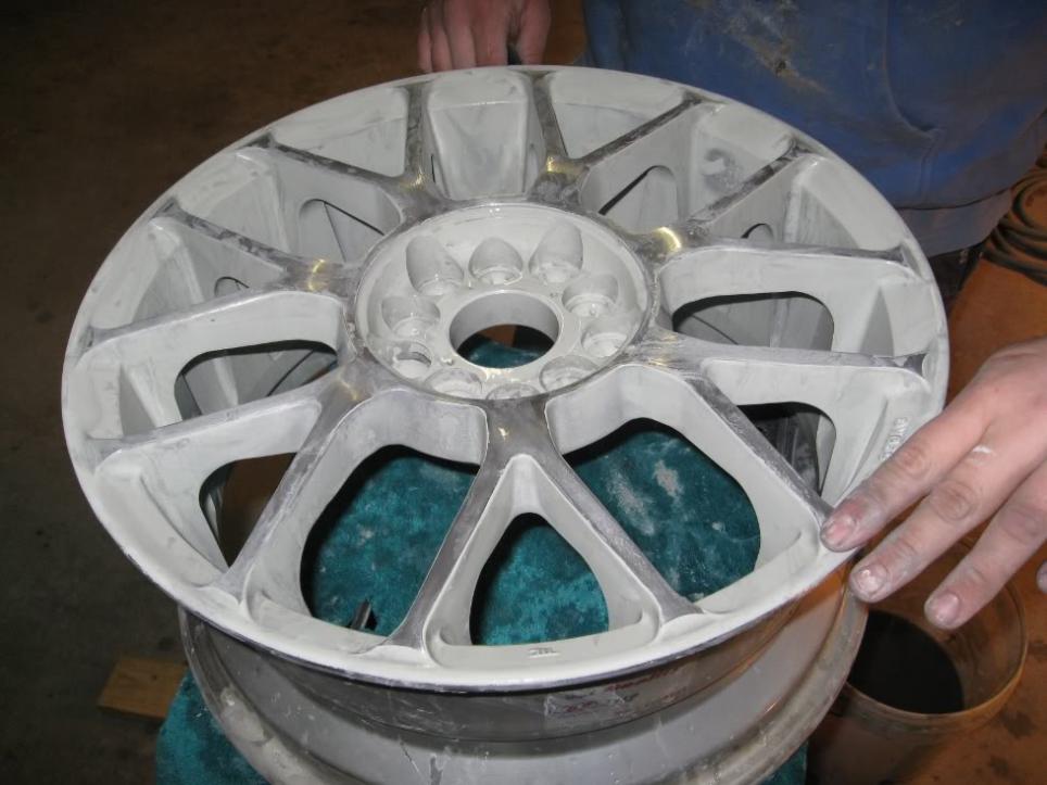

Ah ok thanks Preeny. I know what you mean by the block thing, they're a pretty common thing haha. This was only a practice to see how it would turn out and now that I like the look of the finish I'm going to re-sandblast the wheel and do what you said. Do I have to go to 400 first or could I just start on 120-180 or so and then 240,400,800?
I'd block it straight up with say, 240 and see how it's coming up, then go back to something coarser if you need to. Like i said, start mid-range and see how it looks, then decide if you need to hook in with something more substantial.
good advice there Preeny. and the other posts there too. thanks for sharing!

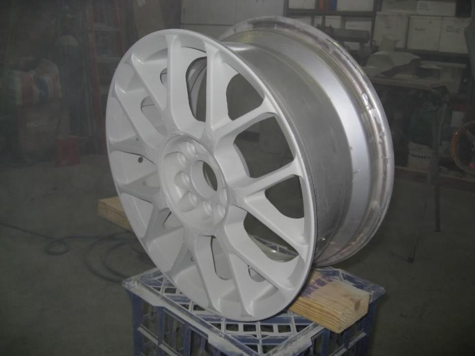

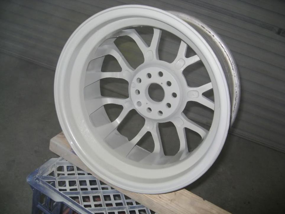

Another update, although this wasn't a very good one unfortunately!
We sprayed some primer onto the wheel tonight to get the effect of the polished/painted idea. It looked great but it will need a different approach to get the result I want.

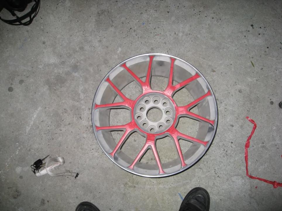

The wheels, already being polished and 'finished', shouldn't have been touched. Anything like wax and grease remover, tape, paint, even fine wetdry sandpaper and rags will dull the surface. So after painting my wheel tonight I've decided that I will have the other wheels 100% paint stripped, tape up the surface I want polished and paint everything until I get to the stage of spraying clearcoat. Then I'll start polishing the spoke surfaces being careful not to scuff the paint (it's easier this way than protecting polish while painting..trust me! lol) and once I'm happy with the result I'll clear the lot.
We only got one coat of primer on tonight because my mate forgot to turn the paint pressure down when he primed my wheels (we were priming bike fairings tonight too) . We got a very unfair amount of runs which resulted in a really bad finish, and basically too much work to bother getting a second coat on tonight. This is my test wheel anyways so I'm able to plan ahead on my other wheels
I like my red tape Oh, and the lip is going to be WAY too hard to tape up so I'm not going to bother polishing it. Pics from tonight:

Check it! More runs than America's best baseball team!
Wetsanding with 800 (and 340 where the runs are, to level them down)
Tonight's finished product:
