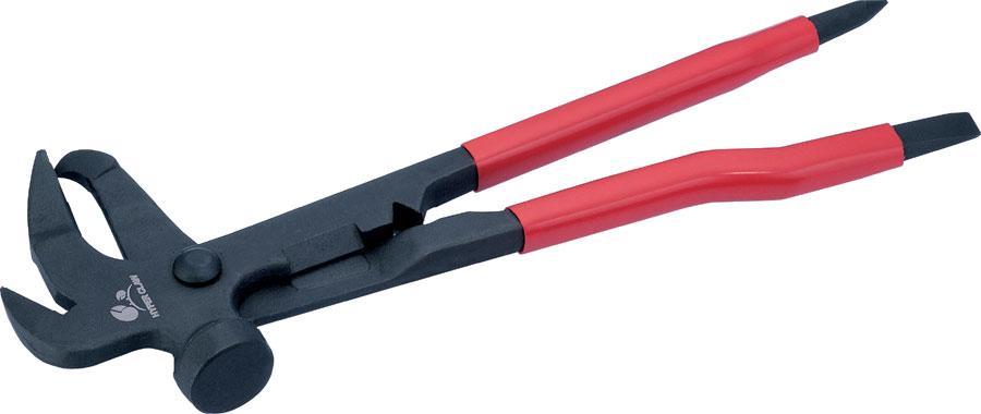

You take them off with a weight removal pliers. There's a pointy bit that goes into the hole on the clip & you remove them by levering from the outside towards the inside.
They look like this for those that haven't seen a pair before.
