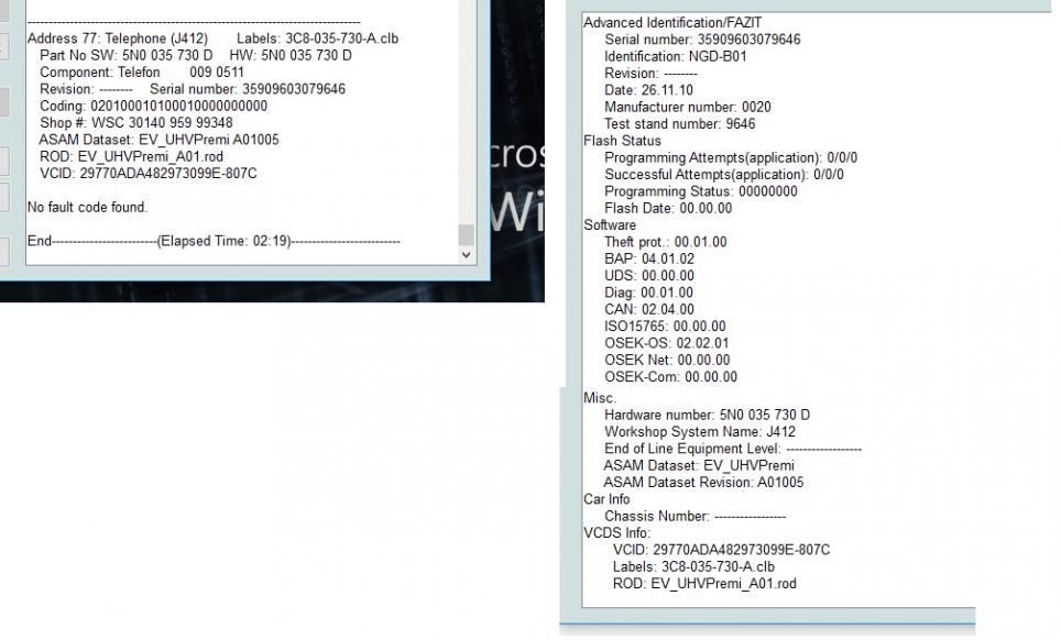

        Hi mate
        Sorry I thought I had already replied. Below is screen grab I took of the HW/SW info on VCDS
          Ok that unit is a Novero HT4 'UHV Premium' module.
          Its from 2010.
          I can't find a firmware update for it that looks compatible.
          It was superceded by the Novero HT5 based unit with part number 3C8-035-730-E which has wifi support.
          This has PR code of 9IC/9W4/9ZG/9ZU/9ZZ
          I would test a newer unit.
          If it works then you have a solution - upgrade to a newer unit.
          If it doesn't resolve your issue then you have a wiring issue.
