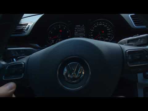

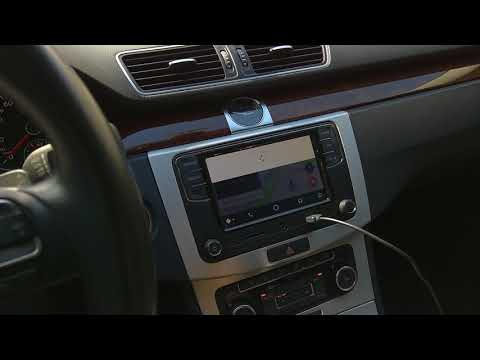

    • Here's a quick glance of my unit in operation (mind you it's all in portuguese):
      Google Assistant activation via the voice command button on the steering wheel:
