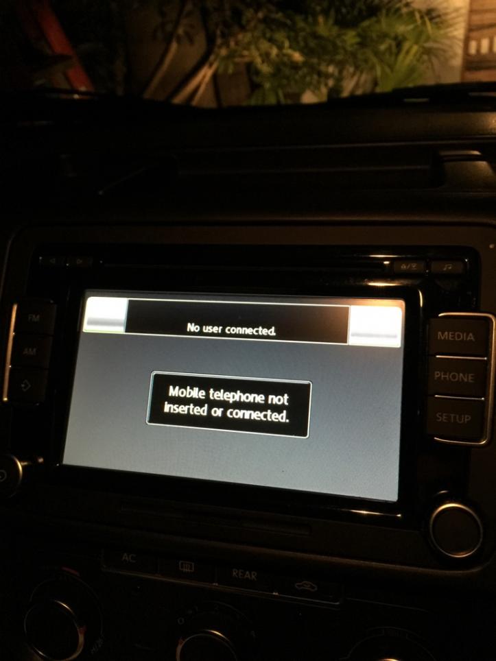

So you mean you cannot pair a phone with the Bluetooth module? Is the phone showing up in the MFD?
Please HELP with RCD510 with 9w7 retrofit for T5 Caravelle
Ok so it is being detected at address 77 as it should. Is it in the canbus installation list? You just need to tick address 77 in the list.
Then cycle ignition off and then back to acc and then check through mfd2011 Skoda Octavia vRS TDI DSG wagon|Revo Stage 1|Race Blue|Leather|Dynamic Xenons w 6000K|9w7 BT|THA475 Amp+active sub|Whiteline ALK|RVC|
Just turn the car off. Then back on again. Check through the menu options in the instrument cluster to see the phone and then you can select a new user, turn phone bt on and searchable.2011 Skoda Octavia vRS TDI DSG wagon|Revo Stage 1|Race Blue|Leather|Dynamic Xenons w 6000K|9w7 BT|THA475 Amp+active sub|Whiteline ALK|RVC|
Is the steering wheel multifunction?2011 Skoda Octavia vRS TDI DSG wagon|Revo Stage 1|Race Blue|Leather|Dynamic Xenons w 6000K|9w7 BT|THA475 Amp+active sub|Whiteline ALK|RVC|
Ok then you have to control it via the RCD. Press the phone button.2011 Skoda Octavia vRS TDI DSG wagon|Revo Stage 1|Race Blue|Leather|Dynamic Xenons w 6000K|9w7 BT|THA475 Amp+active sub|Whiteline ALK|RVC|
^^^^was just going to say that - 'set phone to BT 'on' and "scan for devices"
VOILA!!!MY16 Touareg 4.2Lt V8 TDI/Pure White LED lightbox/REDARC Brake Controller/ Racechip/iDrive Throttle controller
2008 GOLF .:R32/5DR DBPE DSG/SUNROOF/RNS510/PRIVACY TINT/CONTI SC3s/MILLTEK CATBACK NON-RES/9W2 BT/"MYR-032"
If the mfd is the older red screen type it wont show phone. If its black and white then it should have shown when you coded telephone to gateway.DARKHORSE DEVELOPMENTS
