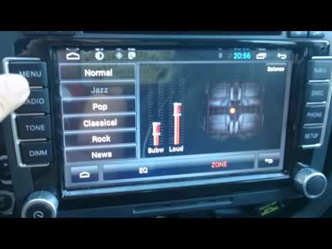

                          • HI, have anyone tried the D90-810
                            Professional bmw car dvd manufatuer
                            I'm thinking on give it a try, my main concern is the sound quality.
                            Here's a video
