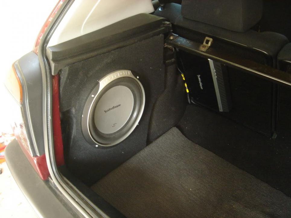

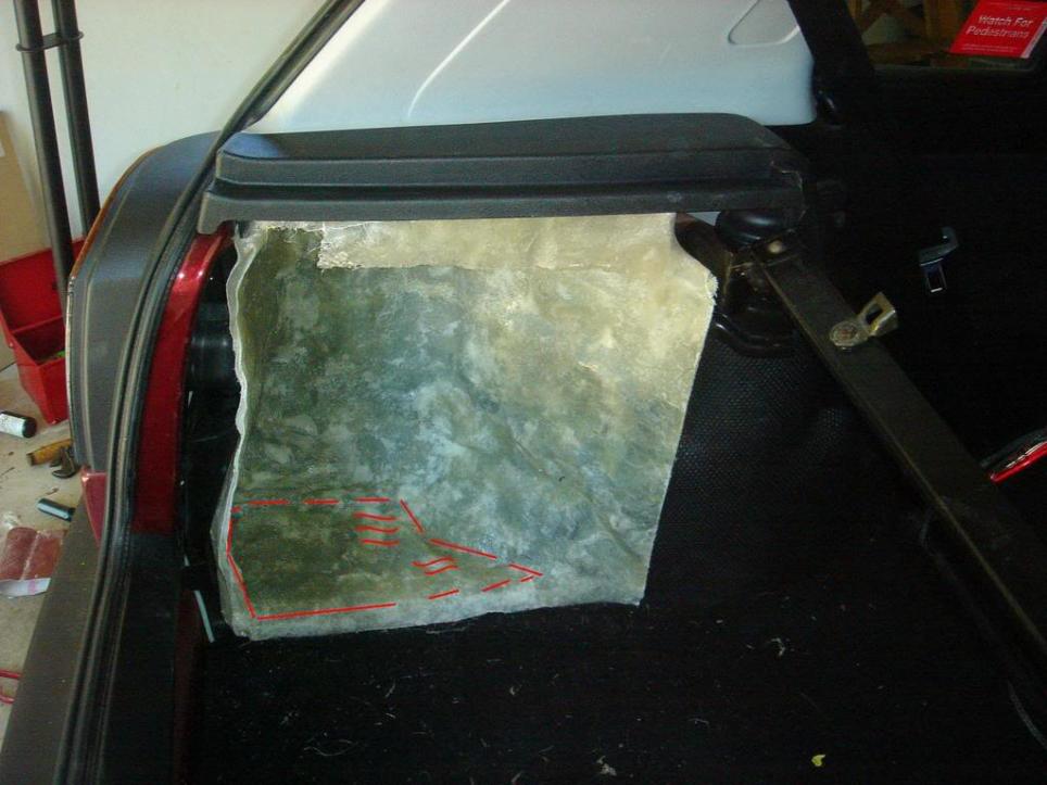

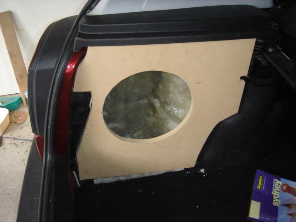

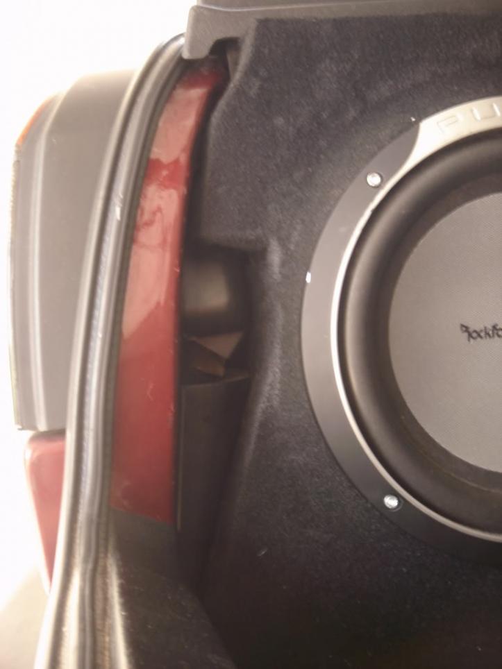

1) yes you will definitely need to seal up those holes, and fibreglassing them would be the way to go. not only will this seal them up but also provide more strength to the enclosure. you may want to add more than just two, however its hard to see from the pics you have posted up and depends on whether your box is flexing. two should be enough for your needs, but you may want to add few more for good measure while you got the glassing materials out

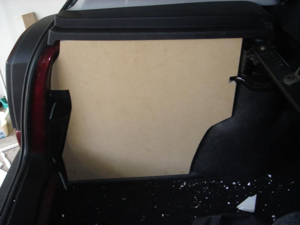

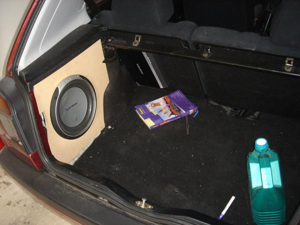

2) Im not sure what you mean by the 'base', do you mean the baffle which is basically the bit that you secre the sub into, or the actual bottom of the enclosure? if its the latter, i dont see any need to as you have already got most of the glassing done. if you are talking about the frontal side which the sub is screwed into it depends what sort of look you are after. if you use MDF you will end up with a flat faced box. another option would be to cut just a ring out, dummy it up into the position that you want, cover this with some stretchy material, and the glass over the top. this is more work, but gives you the opportunity to angle the sub slightly and a bit mmore bling.
have a look at this link, gives you more of an idea what im talking about...
just an idea
