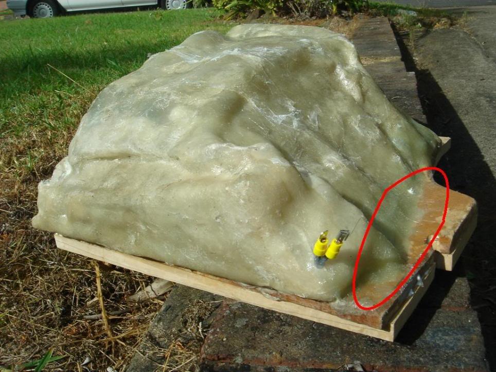

fibreglass Sub box in process
the sound is excellent! I had to cranked up the amp and bit more, I could have use more resin, it makes a fizzy noise at low volume. I suspect it is the undesolved fibre glass. With an overkill of MDF total 2 layers and spacer holding the subbie with glue and screws, surely thats not to blame.Originally posted by KI11Z View Posthowz it sound? and a quick question, how do you secure the fiberglass to mdf without gaps?

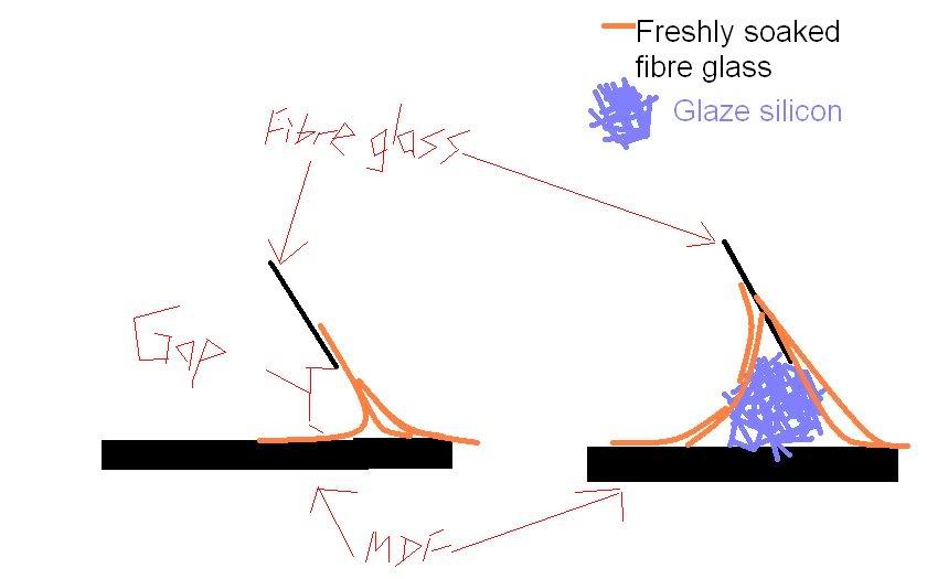

As to MDF to fibre glass. Took me a while to figure as I had about ~1cm of gap to fill. I tried 2 techniques. ..diagram is easier.
Basically filled the gap and glasses it on. But first technique worked just fine ie, sliping the "half palm sized" resin soaked fibre glass between the gap before folding it on the dried fibre glass seems to work better on some areas vice versa.. than glass one overlaping 4-5 layers on.
Note the use of resin soaked fibre glass.. it is rich a green comparatively to pale green/ yellow.. Rememeber Go crazy soaking the fibre glass !!!!! Don't go cheap on resin, turns out stronger as too !!
