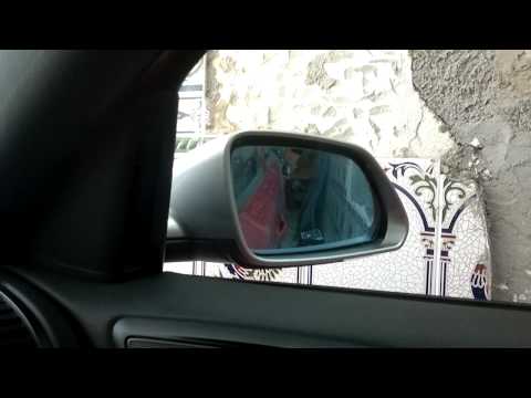

I thought manual referred to the fact you had to have the switch set to L before it would dip when you put the car in reverse, where as automatic would always dip.Originally posted by tigger73 View PostYes mostly. Though because the video is in Spanish it's a little hard to follow.
Instead of right mirror you select the left one (as that's the one you need to see the curb on anyway) and set the "normal" and "dipped" positions. I did play around with the settings from OFF/Manual/Automatic and settled on Auto (not sure if this is to do with DSG/manual transmission or what??) but after a bit I got the mirror to dip when selecting revese gear.
I'm not sure if you need to or not but the mirror selector switch is on the left mirror - haven't tried setting it in other positions when selecting reverse to see if it still works in other setting positions.
Will have to disable it and then work out the "procedure" to enable it again - maybe even make a video with the menus in English
But that was in the instructions of the polar fis guys and clear English is not one of their strong points

OK here's a short video off my phone showing set-up of mirror dipping feature on AutoPolar FIS+ Advanced.
The key thing that I think a lot of people get wrong is selecting the mirror positions before selecting either manual or auto. If the mirror dipping is set "OFF" then selecting the positions has no effect. First select "manual" or "auto" and second step is to set the "normal/driving" and "parking/reversing" positions.
I got this working for the left mirror, but found I had to swap to select right mirror on the selector knob to get dipping on the left mirror after restarting the car. I think this is a special RHD "feature" that will need to get fixed in a future firmware release.
There's also a function to get both mirrors working at the same time - if you select right both will move, but if you select left then only left moves. That's one of the other options in the mirror menu.
I haven't tried to get mirror dipping working on both mirrors at the same time - not that important for me but can understand reversing down a drive this would be good to have.
