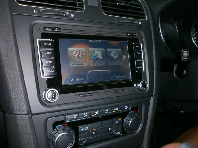

Hello Sandy, while waiting for the new units i have started to think that the ANS810 buttons being on top is not OEM style so am thinking more about the 510-610 units now. i assume all have the same HW and SW and the only difference is screen size, right?

All the units within the same series have identical hardware across the different models.

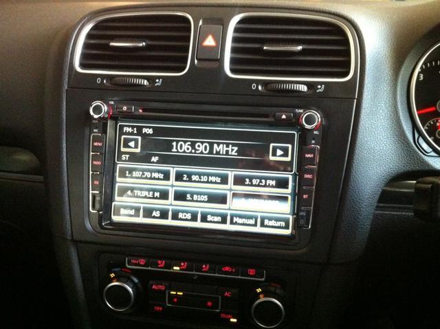

The knobs need to be on top for the 8 inch model because it's more narrow at the bottom. It still looks perfectly stock when installed, but those more familiar with VW would obviously be able to tell that's not an OEM model. There are a few pictures of the 810 installed in dash from this thread if you scan through the first 10 pages or so.
100% true. its all personal reference, i would love the 8" screen in my dashboard but again i always try to stay as near to OEM as possible.
