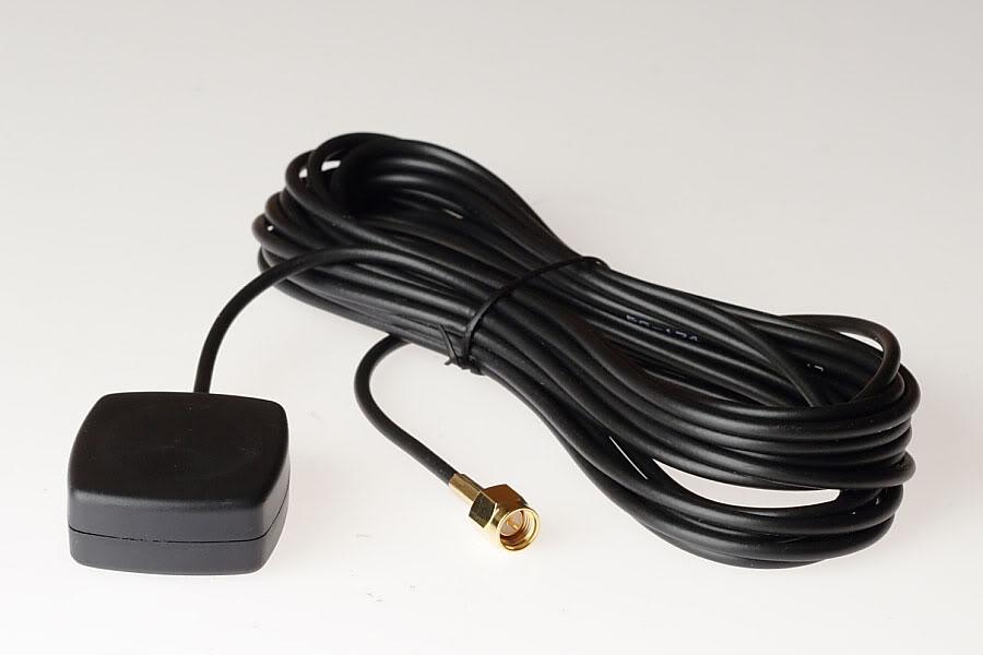

Can anyone tell me if this GPS aerial connection will plug straight into the RNS 510 aerial socket, please?
Thanks
I have a factory fitted GPS aerial (sharkfin) and want to know it this connection is the same. Meaning, I would like to plug the factory aerial fitting into the ANS 810.
No matter, I found this on Ebay
						MkVI GTD fitted with Bluetooth & MDI, CSG, DSG, Xenons, RNS510 with Dynaudio, ACC, Weathershields, Mudflaps, Sunroof, LED Tails, LED Indicators, LED Foglights, Interior LEDs, Tinted, RVC and Towbar - Gosford.
I do believe (but someone with the sharkfin antenna should confirm) the factory sharkfin antenna has four separate FAKRA connectors? If that is the case, you can cut the GPS FAKRA and retrofit your own SMA style plug above, or if you don't want to touch the factory antenna just leave the sharkfin GPS unplugged and plug in the provided SMA antenna. It shouldn't be any issue to hide it underneath the dash, I simply haven't bothered to look for a spot in my car as I probably will take my unit out again numerous times to experiment with
