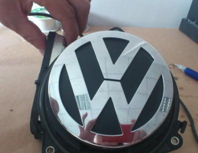

A little teaser of an option coming for the ANS, at half the price you would normally expect
link for info:
http://www.vwwatercooled.org.au/foru...era-73949.htmlTR 08 Golf GT TDI, Custom Code Phase 1, Milltek Exhaust, Whiteline RSB + ALK, APR Carbonio Intake
That looks good.
Wish It worked with Tiggy.
Is there a recommended camera for a MY12 Tiguan that doesn't do the badge thing?Tiguan MY12 118TSI, white, no frills..... Had ANS810 ... Note the HAD ..... Now got RCD510 supplemented by 7" Android TomTom mounted on a HoldMyPhone .... Upgraded speakers Vibe BlackAir front splits and MBQuartz 12" ported sub driven from Infinity Reference 5350a amp .... oh and added fun
Other than the OEM type reverse camera, the only other option I'm aware of is the licence plate light replacement type, which you can order from me or find all over eBay (which is why I don't normally bother stocking unless someone wants to order one from me specifically).
Not sure if you're aware of these, they just replace one of the two licence plate light holders. With the ANS unit which reads reverse path via steering wheel through the CANBUS, you still get full interactive reverse path capability and if you get the CCD type (as opposed to CMOS), you will also get decent image quality. The only down side would be that the camera is not in the middle of the car, so your image will look slightly off centre.
If you buy these off eBay or another seller though, be sure to get one that doesn't have a dumb (non-interactive) hard-coded reverse path in the camera image, since in the ANS the reverse path is added by the unit itself.Last edited by DkN; 13-07-2012, 07:14 PM.TR 08 Golf GT TDI, Custom Code Phase 1, Milltek Exhaust, Whiteline RSB + ALK, APR Carbonio Intake
