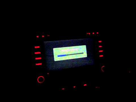

Since the maps are on the hard drive as well, would this help with the navigation performance? I have a US spec RNS-510 (revision F, firmware version 3690) and it seems to take a minute or two for the unit to fully start. The radio portion starts relatively quickly but if I push the Nav button I see a "loading" screen with a progress bar for the rest of the load time. There's also no compass or radio information on the MFD until the unit finishes loading.Originally posted by johnc View PostYou can replace the drive in any model, so yes, but you need to use the right type of drive. I don't know of any 120GB drives, only 128GB. Check the first page for HDD specifications.
And no, it won't make the processor any faster, but it will improve the speed of the scrolling through the music menus. The speed of the unit is limited by the units processor, not the HDD.
Hope that helps!
(If not, then I may have to start considering switching back to the stock RNS-315, even though I like the added features of the 510.
Sometimes if I'm concious of those delays I'll start the car before I sit in it, plus let the engine warm up a tad more. That said, I've never got lost within the first 30 seconds of a trip though
'A minute or two' sounds like an exaggeration, and I have a slower version C unit.
I'll make a video demonstrating it when I get off work todayOriginally posted by Ryan_R View PostSometimes if I'm concious of those delays I'll start the car before I sit in it, plus let the engine warm up a tad more. That said, I've never got lost within the first 30 seconds of a trip though
No, it won't start any faster. The load is from internal flash modules on the board of the rns510.
Sent from my HTC One X using Tapatalk 22011 Skoda Octavia vRS TDI DSG wagon|Revo Stage 1|Race Blue|Leather|Dynamic Xenons w 6000K|9w7 BT|THA475 Amp+active sub|Whiteline ALK|RVC|
That's what I figured.Originally posted by kamold View PostNo, it won't start any faster. The load is from internal flash modules on the board of the rns510.

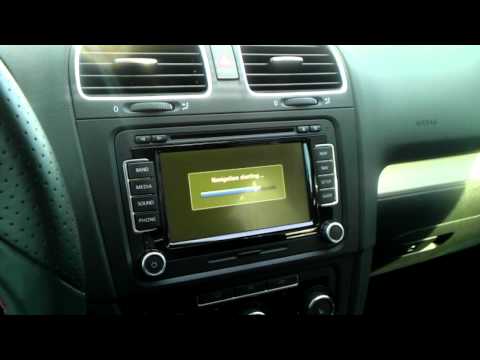

FWIW, here's the video I took after getting off work. For some reason it didn't show the VW logo this time (the car had been off for ~3.5 hours or so) and it definitely took less time to get to the radio screen. I'll probably have to let the car sit overnight and make another attempt.
In your first video you turn it on at ~14 seconds and the map is ready at 40 seconds. That's at an "on" enough stage for me (as I said before, I've never needed to do anything elaborate on the RNS510 before setting off, just select a different music source and show the maps usually), so that 26 second wait time is eaten up by me getting my seatbelt on, and if I need to reverse the load times are further masked by the rear view camera video.
As for the compass delay, I've honestly never noticed it before...
I think for all the RNS510 does it's worth the longer boot-up times, otherwise it's a bit like doing all your word processing on your smartphone because your PC takes longer to turn on.

If this is the usual amount of time to boot, I think I can get used to it. *shrug*
