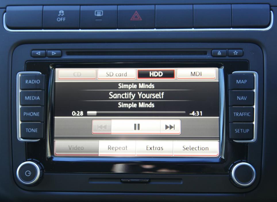

                    Sanctified.
                    Took the tumble and loaded "V4" as per our ebayer description. All good. Recognised it as an 'update', asked me to save or temporary use. 20 minutes later: Saved. Sanctified.
                    Will check out some of the 2010 roadworks around Canberra and see if it knows the difference and report back.
                    Simple Mind
                    MY18 GOLF 110TSI I HIGHLINE I Indium I Panoramic Sunroof I DAP I IP
