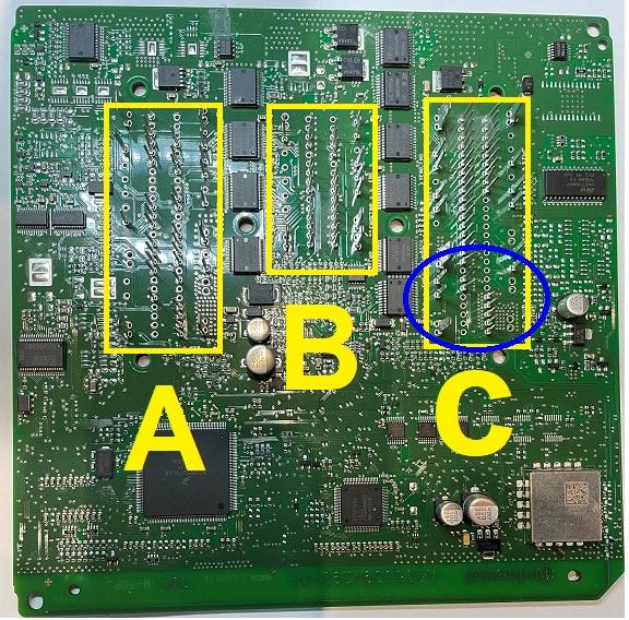

    also, with regards to the actual BCM wire, where can i buy these, and is there a particular size. i notice the outer pins r bigger compared to the inner pins.
    for example, Pin B39 is different to C61

    PS: As for your final question - given that you will only need ONE BCM socket pin - I suggest that you buy from a dealer. Yes, it will be over-priced - but it shouldn't be a large component of cost in the overall project budget!!

      the reason i singled out Leuchte8FL B39 and Leuchte9FL B2 is because my 09-Central Electrics admap shows them as "not active".
      i will however, as u pointed out, have a look for physical pins when i remove the BCM connectors, to b sure.

              So i've finally managed to do a recon on my actual BCM, to figure what actual pins are available/used/missing.
              as u suspected C35, C36, C37 and C61 have no pins, hence can't b used.
              Leuchte10SHUTTER B22 & Leuchte11SHUTTER B23 are in use, occupied (existing wires).
              however its good news with Leuchte9FL RB2 and Leuchte8FL LB39 as they have pins, and are not occupied.
              whilst that is great news, i can't use the BCM repair wire i purchase as its the small version, suited to the likes of C35, C36 etc. etc.
              i need those big pin connectors for B2 and B39, which i'll b ordering soon.
              so hopefully in the new year i will b able to setup the test rigg, and do the coding.
              till then - have a good christmas and a happy new year. thanks for your help thus far.

                after getting the right BCM connector pin, i put one in Pin B39 and another in B2.
                at this stage i've only adapted B39, and left B2 as not active -a spare, just in case.
